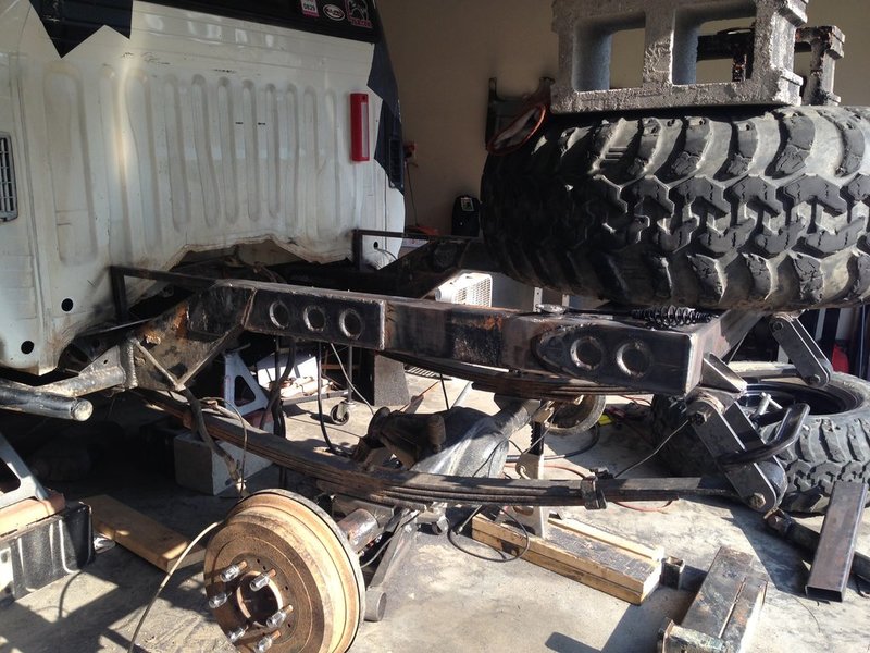

    Nice, I've seen it done similar ways but just wanted to make sure before I burn it in.
    The square tube was scrap I had laying in the floor so I was trying to make use of it otherwise going all the way to the top would be better. And I haven't gotten around to making all my frame plates yet but it's on the list. You can see that I've already prepped for the plates back there. Have the metal and just picked up new tips for the plasma :cool:

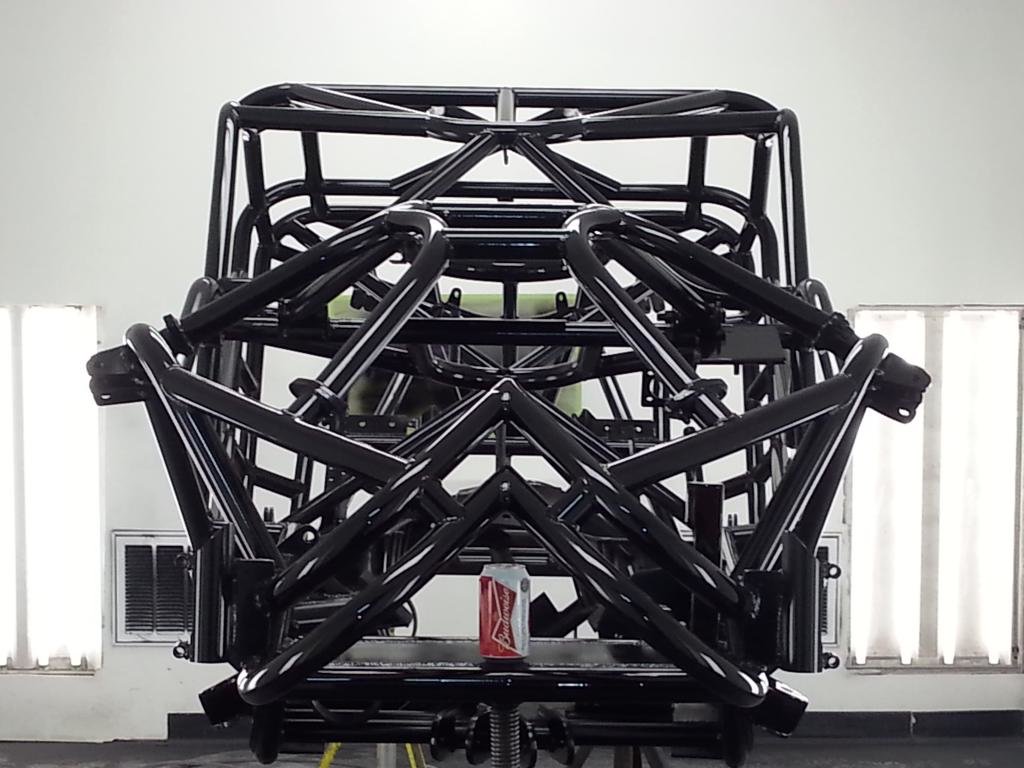

    Some of those bouncers have some cool tube work done to them, but damn the visibility looks like it blows. I guess it really doesn't matter since its stand on the gas until you roll, run over over whats in front of you, break, or make it up the hill type wheeling.

    Is plating the top and bottom of where welded the frame back together really necessary? I plated the inside and outside and I really don't think I have anything to worry about.

    Nah, you're good
