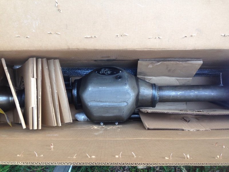

    Progress, almost ready for final weld then paint
    c943755a170b73ec48dc40eec0363bfd_zpsqxha_46f0ae2ba1f6ffdfe6ccb221278dc77562f828ef.jpg
    Supra TT[OP] and thekernel114 like this.

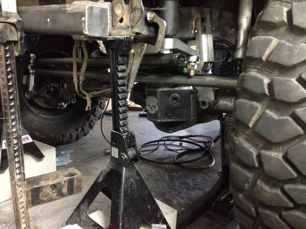

    I did my last official ifs run over the weekend and tried to break the ifs... I ended up blowing another rear u joint and twisted my driveshaft a bit. I ended up having to drive home in fwd since the vibes were so bad on the street. Ohh the irony, the trip that I took to kill the IFS, I ended up needing it to get home.
    I think I have an axle wrap problem in double low, I also think I bent a rear spring since the pinion is now pointing too high. The fj80 axle is also making things worse with the offset diff. I have a traction bar from a jeep I used to own that in going to make work on the taco this winter when I swap it.
