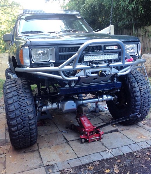

    Things and stuff and such
    I had all the mini axle kewl parts and high pinion, so I shelled $$$ for the TG taco width housing. It's a pretty nice piece for the money, lots of clearance.
    Props for widening your own housing though. If I had a decent shop, I would have considered that task.

    Ah,
    He's not widening, just cutting off the knuckle balls to flip and rotate for caster
