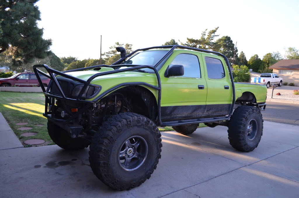

    This is my buddy David's DD! :laugh: yotabeast505 on here....

    he uses that beast for his dd?
