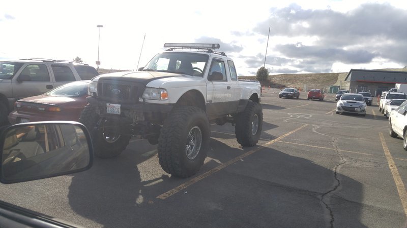

    Thought you guys might get a kick out of this even though it isnt a Tacoma. This Ranger is on 42s right now and recently broke an adapter in a parking lot. Still pretty cool considering it is turbo'd too though...

    Jeebus. I'd like to see the build thread for that thing. It's actually not too bad looking since it's not lifted 4 feet in addition to the tires.

    It looks like a ranger version of rctoy's ride.

    Pretty sure that's his, that offroad park he was at in one of the pics is local. All in all the truck is pretty dang sweet, I think his latest wheel and tire choice might need a bit of a reevaluation until he can beef up the axles though.

    Ooooh, hadn't seen that. Scary, the weight is outside the frame rails too. I thought the commentary from other members of that forum was the funniest part though. Body lifts are pretty popular there for some reason.

    if you count that it's tall on 42's and whit then yes.

    i was more meaning the faggy light bar the ford has and lack of armor.
