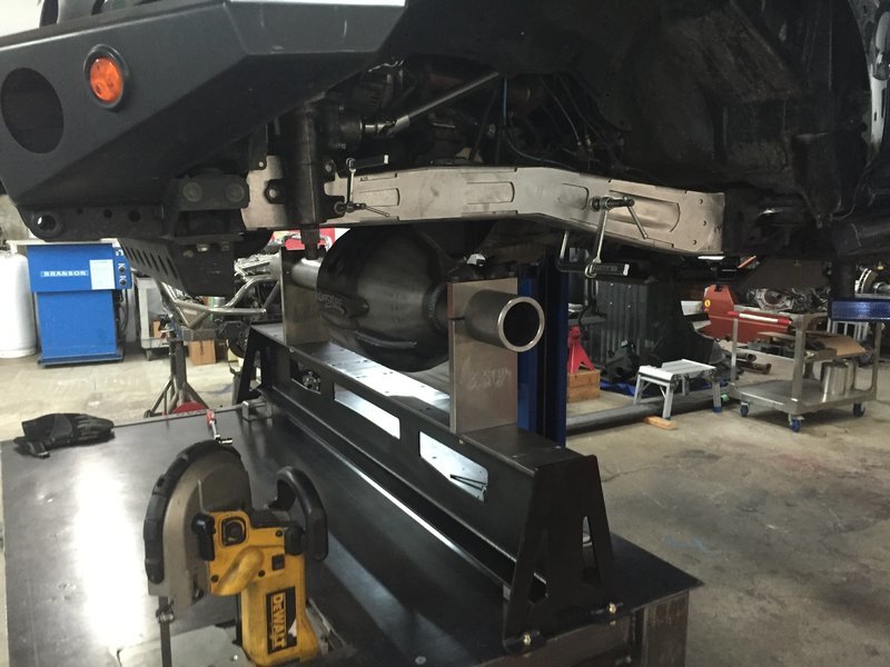

    Yup! Cody is a good friend of mine, I dropped tattooing down to 4 days a week and I've been working for Cody on Fridays helping with my truck and other projects. He is a top notch dude!

    Yes that is why I only roll with him, it's not quick, but I only want to build this thing once haha.
    I'm just excited that I get to be a part of it, if we weren't friends I know I wouldn't be able to. Built not bought can't apply to me as I don't have the skills to build it to the caliber I want. I guess it's #partiallyhelpingbuildandalsobought haha. I've been a part of all the installation of key components, I was pressing in the bearing races for the rear spindles last week, It's important to know how it goes together for me. I don't want to be that idiot with with a high dollar rig who has no idea how to fix it if it breaks haha. I'm a grateful Cody is willing to teach me the process.

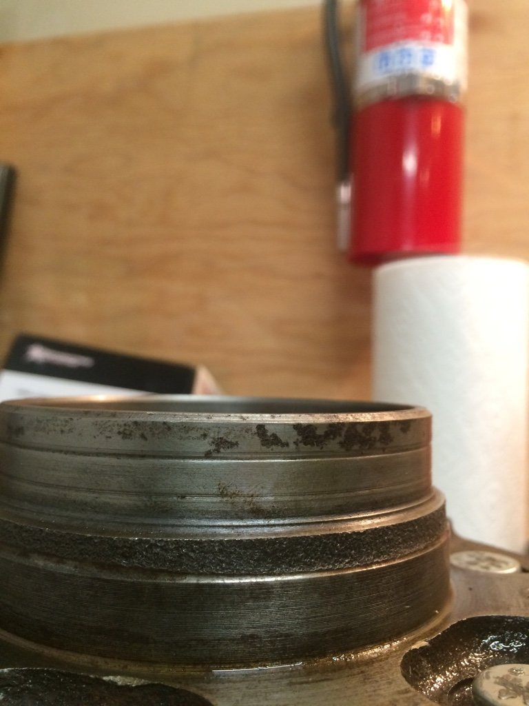

    Anyone know if this 1979 Hub is good enough to not cause problems?
    Edit, this isn't a sealing surface correct? The seal is internal

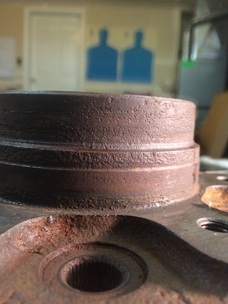

    This is the other one from this axle.

    Correct, the seals sit on the inside, against the spindle.
