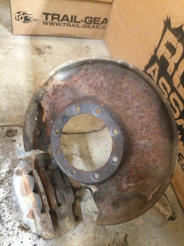

    2008 TRD OR
    Brake splash guard, yes or no?
    Opinions?
    I am anticipating getting this thing in mud and creek crossings, and am torn about cleaning the old ones up or not running them at all. 72712c72730dd5d081ba1291b4699c70_0444fcce027efa1e1c2511acdaefbf74c41bbcb0.jpg

    Redneck92
    Redneck92 Well-Known Member
    Aug 9, 2012
    #84398
    1,683
    Concord, NC
    02 Tacoma Limited TRD
    Just the norm skids, sliders, & 35's
    No to the guard, however it acts as a spacer so you'll need to cut the center part out or buy the one from TG.

    SnowroxKT
    SnowroxKT Well-Known Member
    Dec 11, 2011
    #68604
    5,319
    Kyle
    Anchorage Alaska
    2008 TRD OR
    That's the backing plate eliminator kit from them right?
    Edit: Sweet, I already have it.

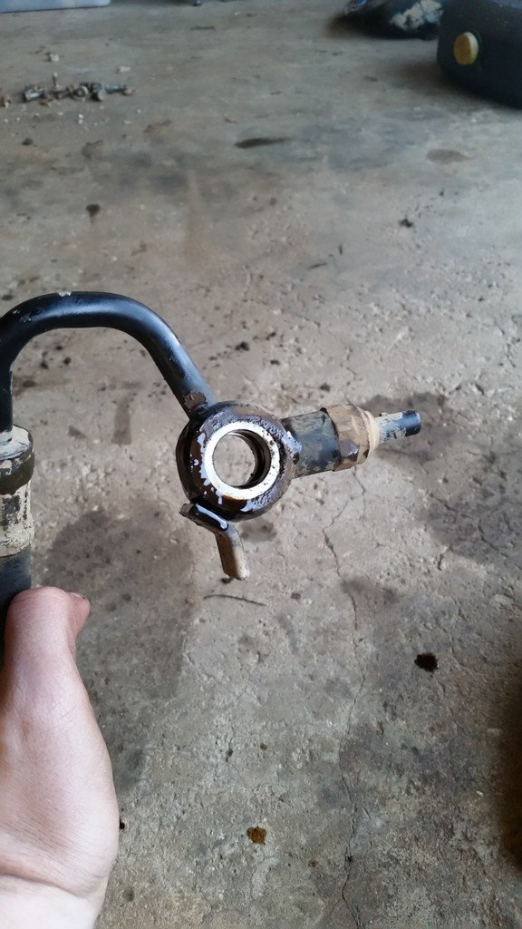

    Hickory, NC
    02 Tacoma, fixed with curse words.
    Lets get a tech question going:
    What does this sensor do on the high pressure line coming out of the PS pump? Will it throw a code if its not connected? I'm replacing it with a 17mm to -6 JIC adapter for my ps hoses, and i cant be throwing codes since the truck needs to get smogged in august.
    If it throws some sort of a separate light for the steering system, i don't care about that.

    ToyRyd04
    ToyRyd04 Taco Transformer
    Aug 5, 2011
    #61217
    1,894
    Greg
    Perryville, MD
    '04 PreRunner
    SAS'd PreRunner Diamond Axles Crawlbox
    It's the idle up sensor, when turning it'll kick the rpms up a few to help spin the pump faster. No light comes on from disconnecting it. Removed all of my lines for the PSC kit.

    slander
    slander Honorary Crawl Boi
    May 10, 2013
    #103909
    8,964
    Hickory, NC
    Badass, thank you!
