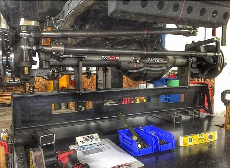

    Opinions on ruffstuff vs. diamond for fabricated housing? Looking at going full width when I link. Ruffstuff quoted $1185 + shipping and I have to send in a pair of knuckleballs. Diamond quoted $925 +shipping if I supply knuckleballs or $1075 + shipping if they supply them

    I think the ruffstuff housing is better but at that price I would go with Diamond and have them supply the knuckle balls .

    Which ever has the smaller center is the one I'd go with. The Ruffstuff housing is nice but the center section is huge and will more than likely limit up travel.

    RuffStuff because I am a fanboy, it's just a sexy ass housing. Also if you are patient wait until 4th of July they usually do at least 10-15% off the stuff they make I bet you can get a better price on the housing.
    Come on, just look at it

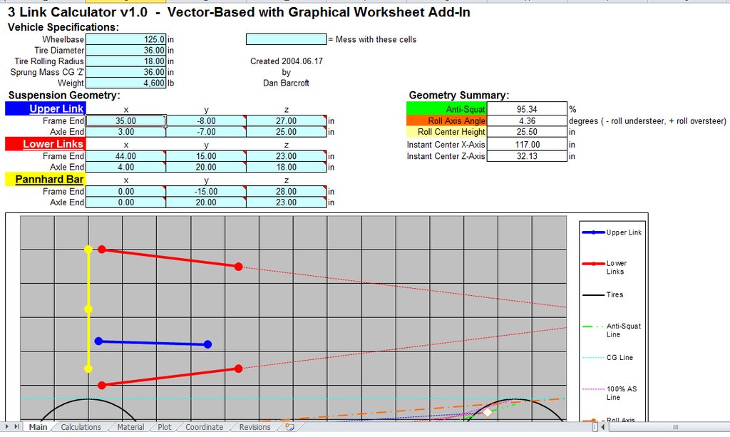

    Wow those numbers are not very simular to mine. My anti squat is at 96% right now roll axle angle is at 3.96 and RC is 19.12 link length is looking close though. What length coils is he running? If you know if not no biggy
    Thanks again,

    Pretty sure he's running 12's.
    Here were my old link numbers. New ones are super similar
    3378jakesr5[QUOTED] and ckeene9 like this.
