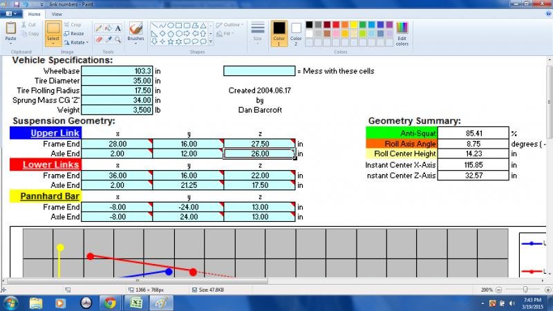

    these were preliminary numbers before I started building. I'd have to crawl under the truck to pull the actual measurements and enter them back in here. They are for sure different.
    Also, I am running 12" Radflo Coilovers
