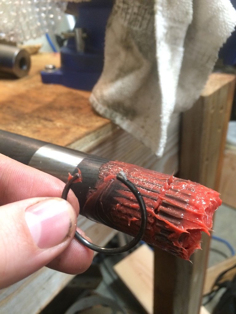

    When installing my axle shaft and long fields, do I need the compression c clip? I've heard both ways but don't want to blow anything up...
    Edit: Running it, I'll try and find another for the other side since I broke that one coming out of the donor axle.

    What's the argument for not running it? When you go to pull the shaft and birf out the birf would just slide off the shaft and you'd be left with like 2" of shaft to try and grab to pull out.

    What I came up with.
    For not running it:
    1. Not necessary (not sure about this...)
    2. I already have a locker, so the axle shafts won't slip into the diff too far. (Only half the reason to run them anyways.)
    3. If axle shaft breaks off inside birf it's hard to get out
    For running it:
    Stops the axle shaft from migrating too far into the birf causing failure

    I doubt you'll ever break the shaft, the birf or the gearset is always what blows up. I don't think the shaft can slide too far in the birf. The birfs blows up when they are put in a bind at too much steering angle.

    If the axle shaft can't slide too far into the birf I dont really see the point in running it. If I can find one locally though I'll run it anyways.

    Just thought of something. The axle shaft has a smooth place the the axle seal seals on. With the clip installed the shaft won't float around allowing the seal to ride in the same location on the sealing surface

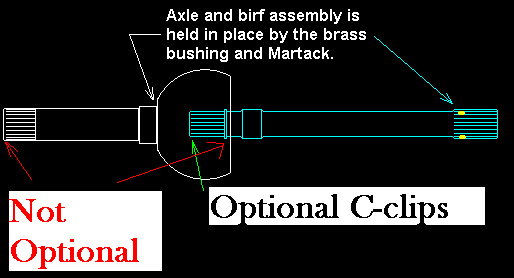

    You have to run that clip, it prevents the shaft from binding and the inner shaft from stripping out. The clip thats optional is out by the hub.

    So many opinions over on pirate... so much "I've done this and it worked..."
    For me:
    1. Air Locker prevents axle shaft from going too far into the differential (I tried this without the Longfields to check, and the axle shaft stops before the splines reach the sealing surface)
    So, martacking seems pointless to me.
    2. My axle shafts do NOT have two places for c clips. They only have the one the diagram above shows as optional. I installed the short side last night and will try to find the "optional" c-clip for the longer side. (See above picture for reference, post #6949 in this thread.)
    3. I am planning on running the c-clips holding the Longfields out against the brass bushings.
    So I will be running all c-clips that are available to me on my setup ymmv.
