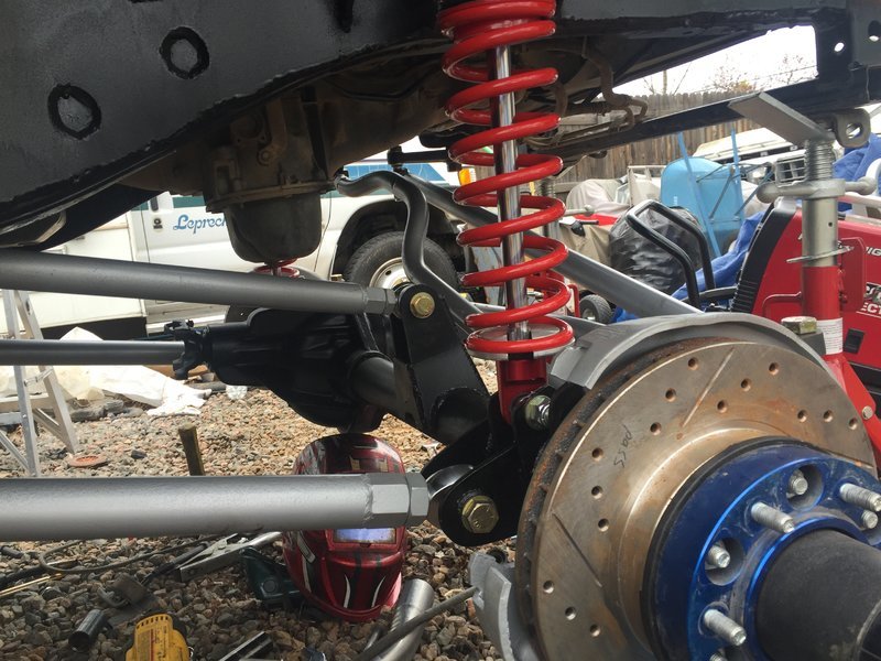

    Well its done! I have to fine tune a few more things and then i can start driving my truck again!

    looks like your drilled and slotted rotors are on the wrong side.

    Yah we noticed that... I have to pull it all apart here and flip them.

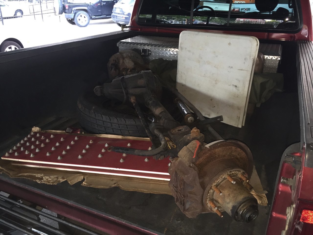

    I'm wasn't planning on buying axles just yet, but for $400 I jumped on this one.
    1994 D60, 4.10's, open diff, out of an F350
