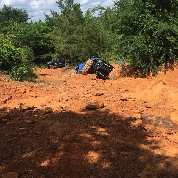

    i think i have a pic actually

    Attempting to go up Twister at Barnwell Mountain. I wasn't spinning the tires or bound up either. I'm guessing it was already damaged from previous trips.
    Let's see it! I'm sure it will show just how unimpressive of a predicament I was in. :D

    only one i got ... where it was already broken, but tried to take this line and heard a loud PING
