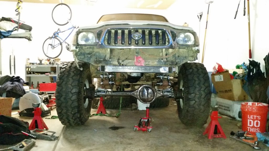

    The welder ive been borrowing is being a pain in the ass and fucking up, and im ready to burn the truck down and i needed some motivation. Last night i swung the axle under it and mocked up the tires and wheels:
    And i ordered a Hobart 140.

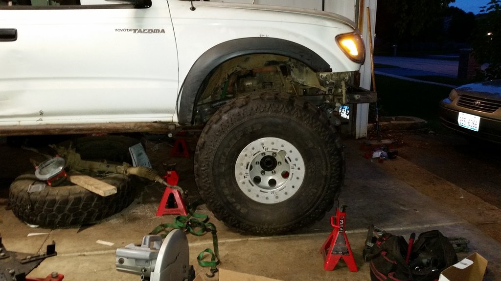

    And side shot:
    I still don't think ill have to tub the firewall at all, maybe some pounding with a sledge. I need to flex test it but that may be the very last thing i do, keep in mind the axle is going to swing forward on compression. It looks tall as hell in the above posts front shot picture, probably because i squatted down to snap the pic, however its only 2"s or so taller then the rear.

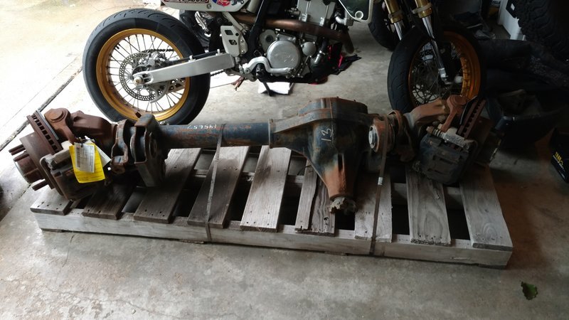

    That's the reason I chose the 05+ superduty axle, 35 spline factory and large knuckles.
    I plan to keep the unit bearings for the time being, seen good luck with them and I think they will be good for street use (the aftermarket axles run the 99-04 unit bearing size) and the 05+ have a larger/updated unit bearing.

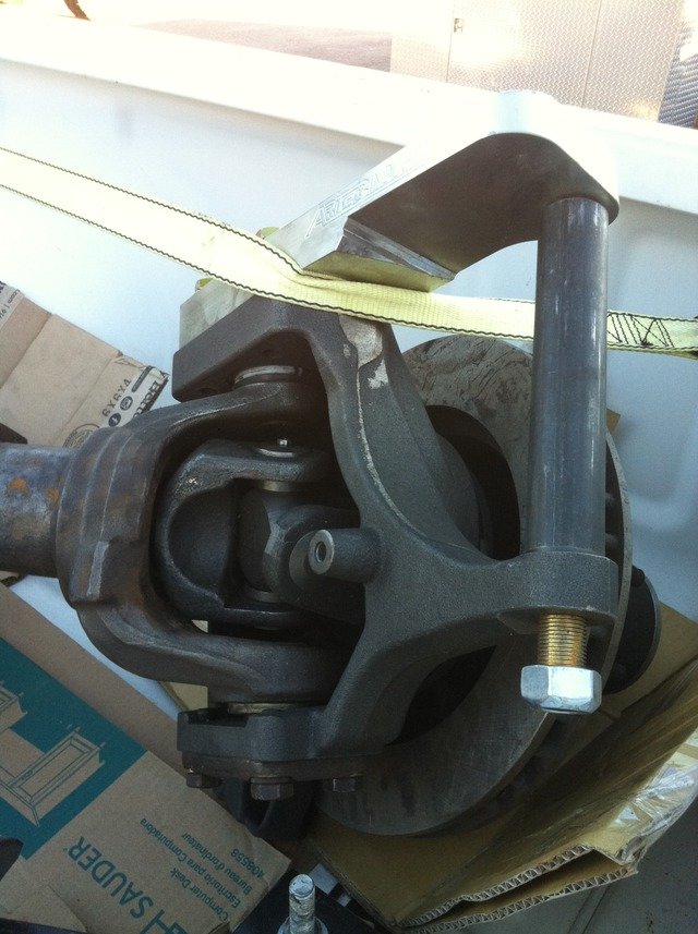

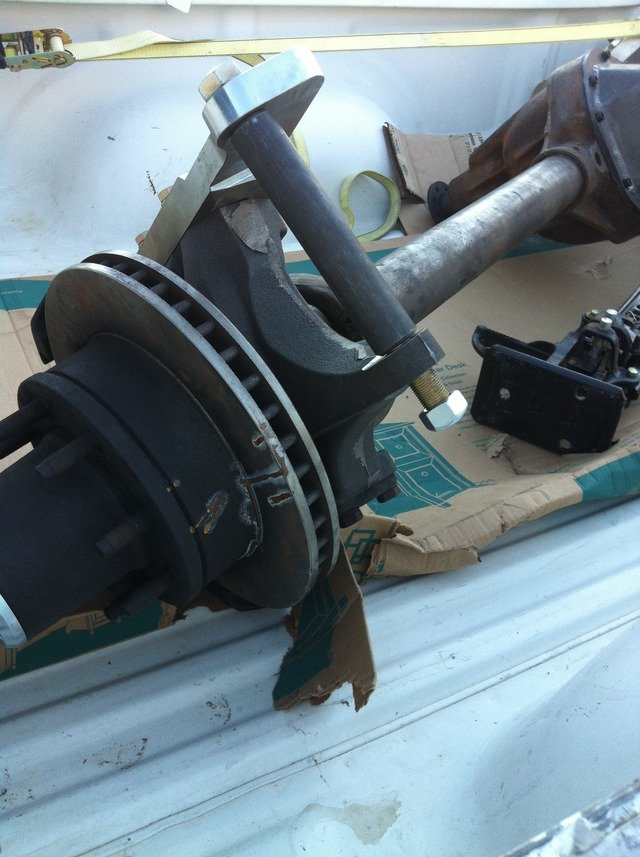

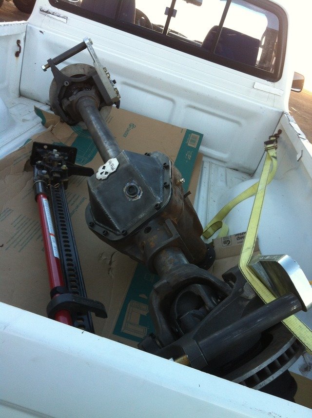

    Dude, how in the world did you unload that monster of an axle by yourself with no lift! That's insane. I ended up borrowing an engine hoist from a friend, which made the job super easy of course. I think my D60, the way it is built, comes at about 525lbs :eek:
    I was certainly referring to Weaver fabrication above. Guy has a great reputation and the prices are really good. That's what I would have done if I got a SD axle.
    Yea, prices for kingpin D60s are ridiculous. Way more $$$ for the 79' ones, as those have more axle tube exposed on the driver's side. Mine is from a late 80's F350, which has less driver side tube exposed than the 79', but more than the SD. I guess it is somewhere in between the two. But it was enough tube exposed to weld shit on it relatively comfortably.
    This is my axle.

    Very "carefully" ha. I got it ratcheted out to the point of teetering then used my motorcycle ramp and had it almost to the ground all the way when the pallet got stuck so I just pulled the truck away and let it fall a foot. No harm done since the pallet took the force.

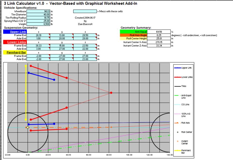

    Besides the fact that this is mostly guess measurements, this is what I should be aiming for correct?
    Edit: link length is probably on the short side and needs extended
