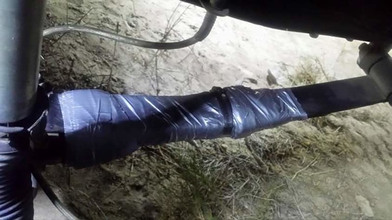

    First night run for the summer season and broke a main leaf..time to link :D. Trail fix using duct tape and a hose clamp to get back to camp..
