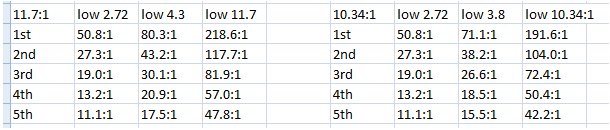

    Here's all my available ratios with a 11.7:1 and 10.34:1 Atlas 4 speeds

    Damn, that gave me a headache lol That's a shit load of options and gearing.
    Well...I hope mine works out long term. It's too late now to change though.

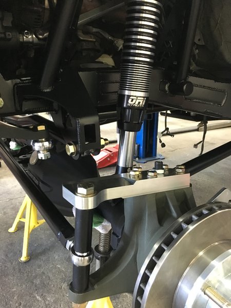

    2021 Tacoma TRD OR
    Chomping at the bit, getting closer!
    Nate87, seanpistol, planesane and 7 others like this.

  11. Jun 20, 2016 at 10:17 PM
    #7211
    Ugly Betty
    Ugly Betty Well-Known Member
    Dec 11, 2011
    #68587
    1,658
    mark
    TX
    85 extra cab on propane
    1985 ex cab, 92 toyota pickup, 95 4runner
    That is sooooo beautiful!!!!

    SOLID keyed knuckles with Artec steering arms. I have the exact sep up...gottla love how they use bolts instead on studs :D
  13. Jun 20, 2016 at 11:29 PM
    #7213
    bayareataco
    bayareataco Well-Known Member
    Aug 15, 2012
    #84860
    3,503
    Jimmy
    Petaluma
    2021 Tacoma TRD OR
    They are pimp, so fuckin beefy and well designed. SOLID makes some awesome shit.

    Originally I wanted to go with Reid knuckles. But my axle builder introduced me to the SOLID brand. I immediately like their keyed studless design. The knuckles are just massive and beefy. Not saying they are better than Reid's but they are certainly different.
    The Artec arms are just insanely pimped out lol. I havr never seen steering arms that impressive. And with the tie in kit for thhe double shear setup the whole thing becomes a tank.
