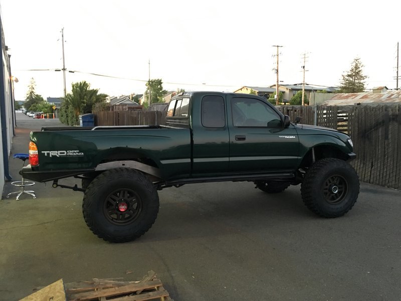

    those springs are going to be tall, try and find a 4 leaf set of 63s at a junkyard, that will already be a 3-4'' lift. So a 3'' lift 63 will be pretty damn tall, guess it depends what you're going for. This is only a 3 leaf 63 pack and 14'' strut in the front, 25'' frame height.
