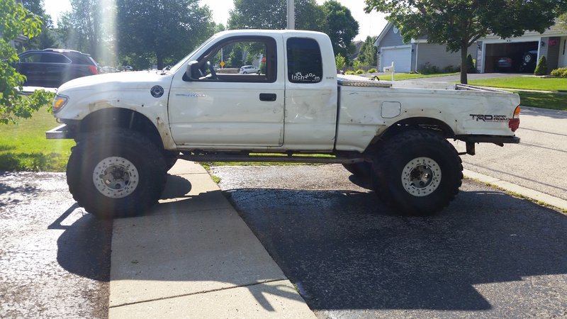

    Got it back on the road, now its time to knock out the long punch list before going wheeling on Friday.

    Spent the entire weekend doing an allpro 3 link sas kit. It's less kit and more fab than should be for the price and the instructions for it are piss poor. just saying if you're going to sell a kit and have instructions make it worth the money.

    lol, that's the way it always works right?!?! My wife's freaking out more than me, we are splitting the drive over 3 days to sight see so im not too concerned, and ill have spares/tools to fix just about anything that could break short of a weld failure on the highway. The guys i'm wheeling with are renting a house with a garage and will be bringing welders, chop saws, steel etc.. so if it breaks there wheeling it will get home!! 4 untested freshly rebuilt/built rigs, one more that breaks anytime it hits it the trail and one that's been properly shaken down, its gonna be awesome! I'm most concerned about highway manners, i had it up to 70 on a narrow bumpy two lane farm round and it was a bit sketch, but i think my toes out of whack. Hopefully that fixes it that or i will be cowboying up and riding the beast for 2000 miles of highway driving LOL!! I also could just be used to driving camry's for the past 4 months as well.

    Sounds like my kind of trip. I live for the adventure waiting around the next bend, whatever it consists of, lol. Sounds like you need to get out the tape measure and get that toe set for sure.

    I set it before i hooked up the draglink, but i think i need to take another crack at it. It visually looks off LOL!!
