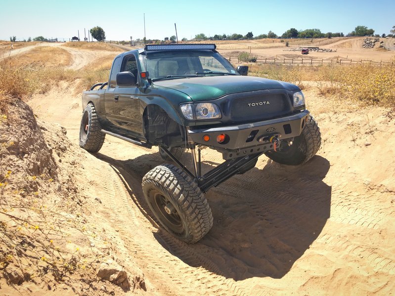

    Damm! Thats Bitchin!

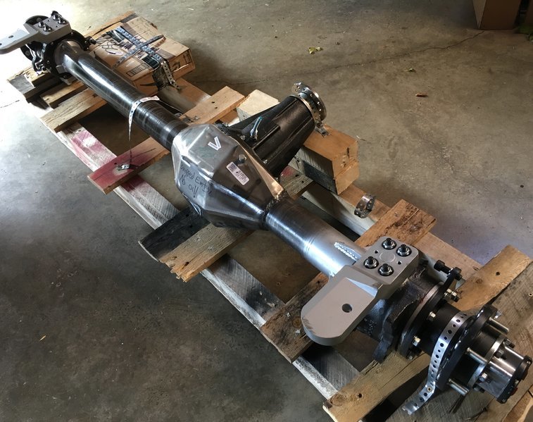

    Finaly the rear 14 bolt arb

    Just the diamond up front and stock rear for now. Gotta recoop a little before I spend money on the rear.

    How much did the diamond run you if you don't mind me asking? And what options did you go with? Also what is the width? Sorry for the question bomb lol

    No problem!
    With shipping to Hawaii, was around $6800. 4.88 gears, arb air locker, I'll be re using my factory rotors and calipers. Not sure on the exact width, It's about 4" wider than stock.

    22,457
    Sick. I like diamond axles really is why I asked.. Thx for info

    Thanks! I think it's the standard Toyota gears so 8" diff. I'm not going over 37" tires, and mostly just dirt trails here.

    :eek::eek: That's a lot of cheese. That's two fully built Dana 60's on the main land. I do understand you gotta do what you gotta do.
    this is all true stuff. Just putting this out there. I ran a mini truck axle with a 8" HP diff with 5.29's and never broke the diff just a chromo axle here and there while on 37's and wheeling like an asshole.
