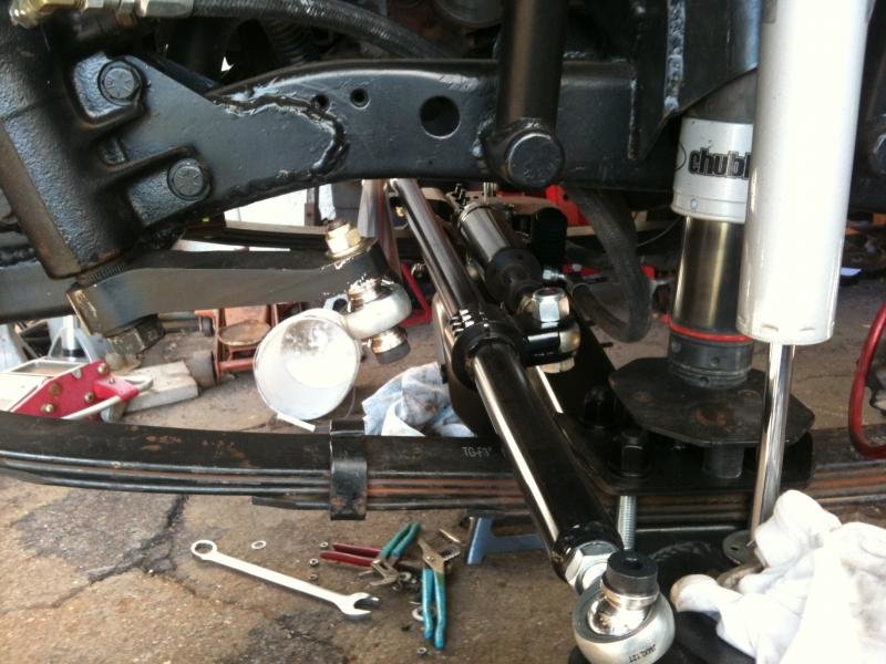

    Yeah the ones I have seen go right in front and under the shocks. We have a bump can laying around so may shove it in there and see. Also picked up a set of 12" fox with the adjusters on them for front and that should help some. And also want to get a flat pitman or 3/4 less drop from sky since its shorter and will hopefully let me move the axle an inch foward.
    Was thinking of doing something like this if they will fit under the shock. A platform above the u bolts. Wider space to hit and wont mess up the u bolts but not sure how they mounted it.

    Its probibly just welded on the plate. My problem is my springs are directly below the frame rails so i would have to mount mine inboard of the frame and build a landing pad... booo

    Thatll probably be how I do mine.. Not enough room on the outside of the frame.
