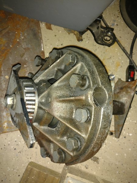

    IMG_20161020_212307346.jpg IMG_20161020_212313368.jpg IMG_20161020_212323064.jpg
    Anyone recognize this?

    Looks like a Detroit for a 14bolt but not 100% :confused: If it is and it is in good working order that should save you some $$

    Does that have 2 cross pins? If not that may be a factory gov lock, which sucks. Google 14bolt detroit and you will see what the detroit looks like, its a lunchbox style on that axle, however if its a gov lock (factory limited slip, 1 cross pin) then there is not detroit for it and you may be SOL.

    There are 2 cross pins...what's that mean?

    Doode..it means that it might be a Detroit locker. As slander recommended, Google photos of a Detroil locker for a 14b axle and compare the photos with what you have. The key item being the 2 pins.

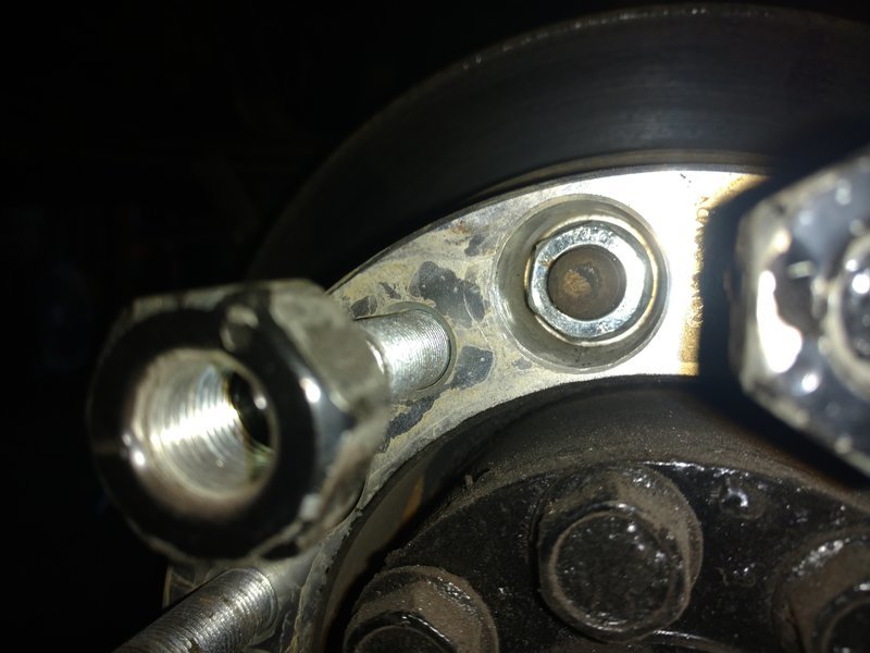

    Sweet!! TIMG_20161021_184739110.jpg hat'll save some money, provided it works. Now I just gotta get the damn wheel spacers off of it. I don't believe there is a socket known to man that will get to these bastards. How he got them on is beyond me. I've tried 6 sockets and none fit. 21mm is to small for the lug nut. 22 and 13/16 wont fit on the hole. I see a day with a cutting wheel in my future

    Try thin wall sockets? :confused: (not sure if they sell these things anymore, but I have a small set that I bought years back)
    When you find a socket that fits apply hit with a torch a little bit to loosen them up (or soak them with PB blaster)

    I don't think they sell them anymore. I bought a "Thin wall' on Amazon that isn't. Its just a stanard thickness chrome socket. I checked the Snap-On and Matco catalogues online and dont see anything. I'm gonna take a spacer from the front to Lowes, Sears and Northen tool and see if I can find a socket to fit. Might even let my buddy with a lathe try to turn one down.
    Push come to shove I'll take a box of cutoff whells to the bitch and cut through the spacers and all the studs. But I REALLY don't wanna do that

    What materials are spacers made of? Can you bastardize them with a torch?
