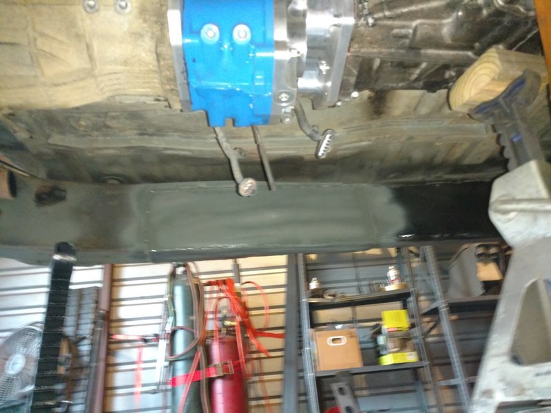

    Four more hours at work, wake up and get back to work cutting and grinding on Basketcase. Can't wait. I should be without trans crossmember tomorrow and the last of my rust should be ground away and plated over. Then I can work on unfucking the steering box mounting

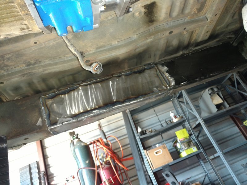

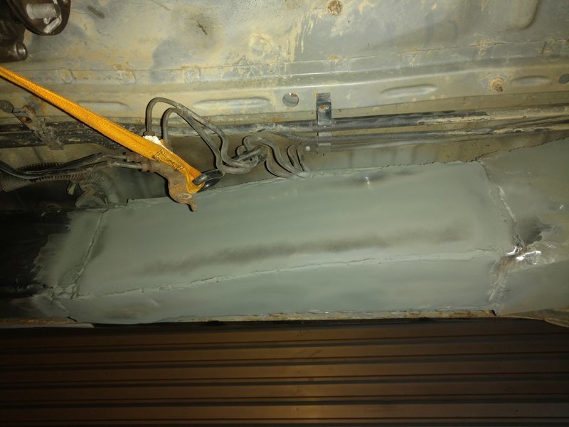

    Mission accomplished....ran out of primer though. Ordered DOM sleeved bushings for my trans mount/skid plate, hopelully they'll be here in time for me to start woriking on that friday.
    Cutting out the trans crossbemeber was a bigger bitch than I remembered.

    You are making great progress man.
    I assume that blue thing under there is an inchworm lefty. are you planning to run duals or keep just the lefty?

    Its an inchworm crawlbox with an FJ case behing it. I just got a triple stick in the mail from these guys http://www.radesignsproducts.com/triple-sticks-1.html to control it all. @ahspurlock opened the Tcase for me and did the mods for the twin stick. My DD has a problem with having enough gear for my heavy ass 37s. I didn't want to run into that problem with this one. Maybe WAAAY down the line I'll do an V8 conversion to Bsketcase and throw an Atlas in there at which point my DD can get the Inchworm.
    We (mostly @ahspurlock ) swapped the 4.56s in my DD last night to 4.88s so hopefully that will help its issues. I was ussing first and second WAY too much on the street when we were in the mountains of Kentuck near Harlan.
