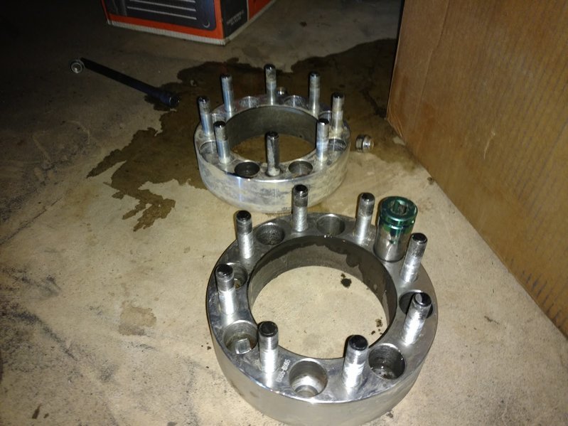

    VICTORY!!!!

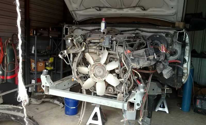

    Ever look at your truck and think an LSx swap would make more sense than regearing?

    so what did you end up doing to get them off?

    Ground down a socket to fit with my 1x30 belt sander. By the time it fit the wall of the socket was 1.3mm and still BARELY fit. I'm surprised the socket didn't crack.

    That's pressuve that it didn't crack!

    Has anyone on this board done an LSx swap on their Tacoma (4x4 I think I saw one on a 2WD)?

    I have not seen a LS swap in a tacoma. I'm sure somebody has done it somewhere. I've seen them in the older trucks. Vortec swap is a cheaper option; just a heavier engine.

    @Speed Freek has a 1st gen with a LS1.

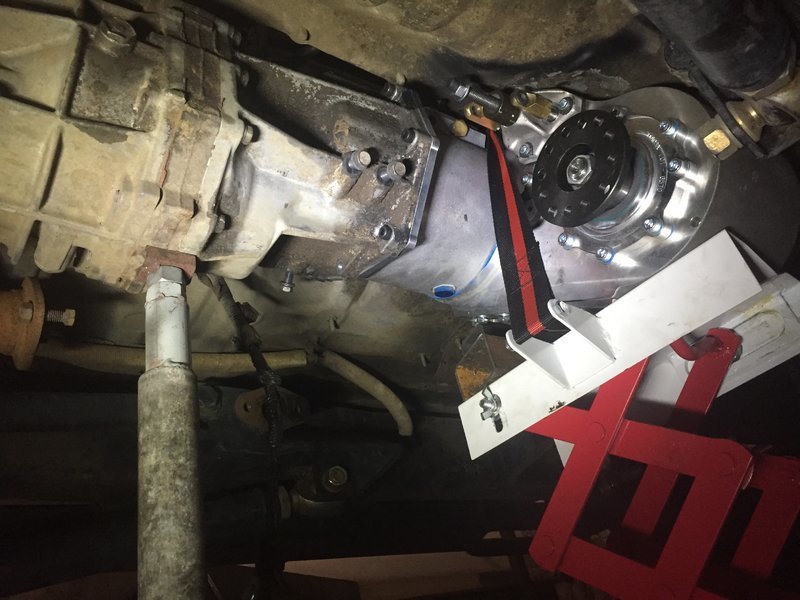

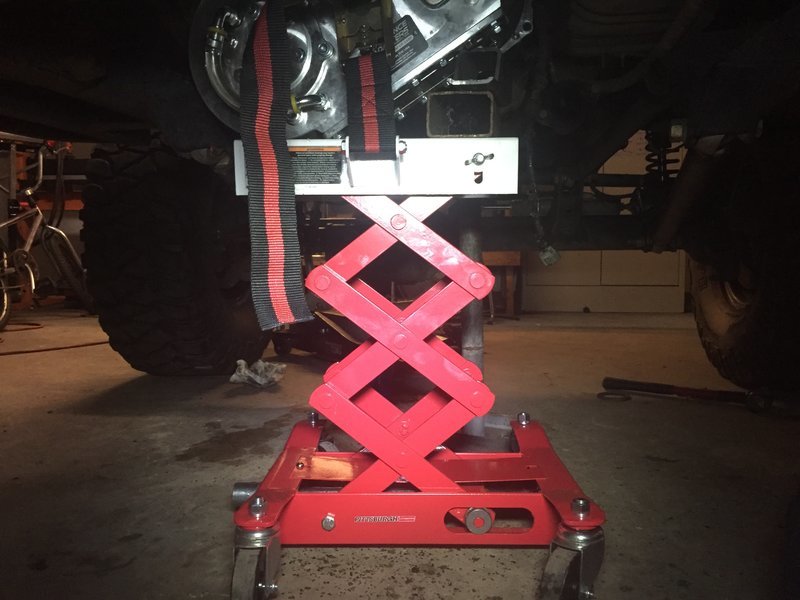

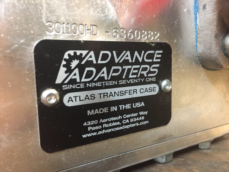

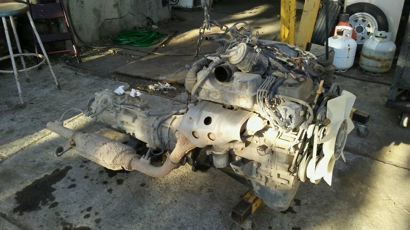

    Atlas is bolted up. Time to start working on everything else. Btw, that transmission jack is a lifesaver.... $80 after the 20% coupon at harbor freight. Uses a 1/2" drive impact to raise and lower.

    Good call on the tranny jack.
    The atlas 4 is even heavier than the 2spd atlas. I just don't see how anybody can install it with bare hands! Well...maybe it can be done with a few extra pair of hands holding it up :)

    I tried to balance it on my jack while pumping it to raise it by myself... 0% chance that was going to work without severely hurting myself. It may only end up getting used every once in a while but it sure beats injuring yourself.

    Using the same jack, for the price its a no brainer. Works well when dropping the tank as well, nice controlled movements.
