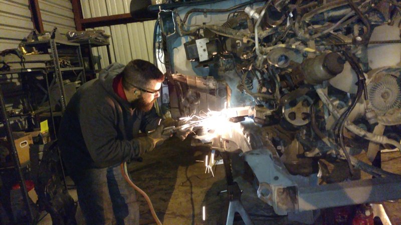

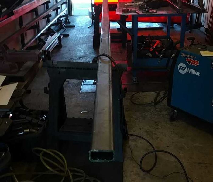

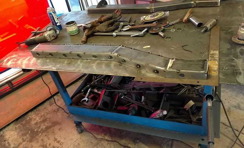

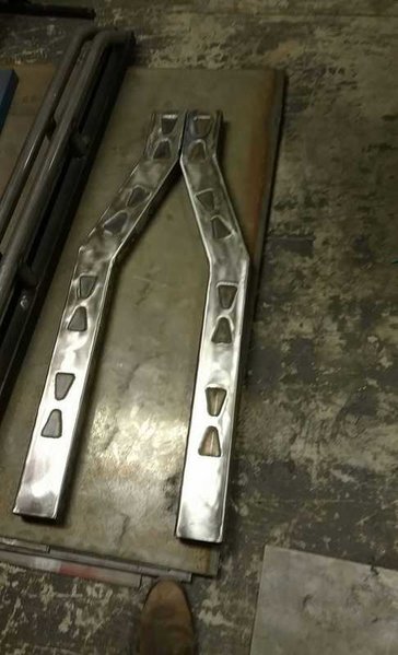

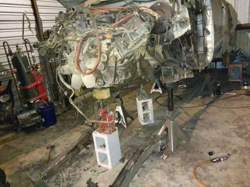

    1480701940351_zpslrwlyg3p.jpg 1480712822450_zpshbxmd5nv.jpg FB_IMG_1480736738583_zpslfmos7br.jpg IMG_20161202_183606891_zpsizg1zjrm.jpg 1480727070452_zpsrypp5zed.jpg
    FUCK THAT SECTION OF FRAME

    02 Tacoma, fixed with curse words.
    That will make your life WAY easier!! what did you use? 2x3x3/16?

    2x4 3/16 with 1/8 fishplating on all sides, more to look awesome and show off Eddy's talent and look awesome, than any other real purpose. It's strong as fuck now though. The frame rails are lifted a couple inches to clear the panhard easier and the engine will be lifted as well (not that it's staying for long). Attaching it to the frame will be the trick, but I have a plan. I'm going to order a new core support then cut the mounts off of my old frame and weld it in to get that all lined up properly. In the end this will give me a much better product with more clearance for things like exhaust, tires, links and front drivehaft, with no rotten metal hiding underneath.
