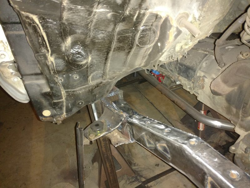

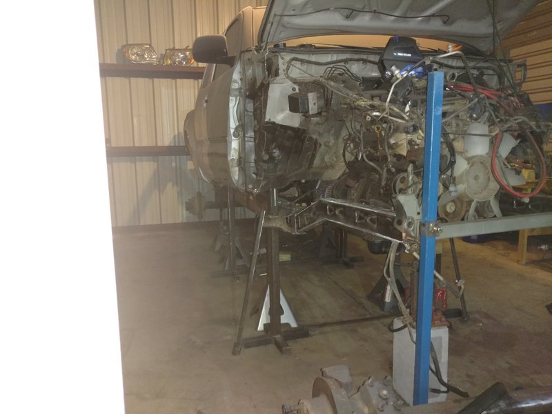

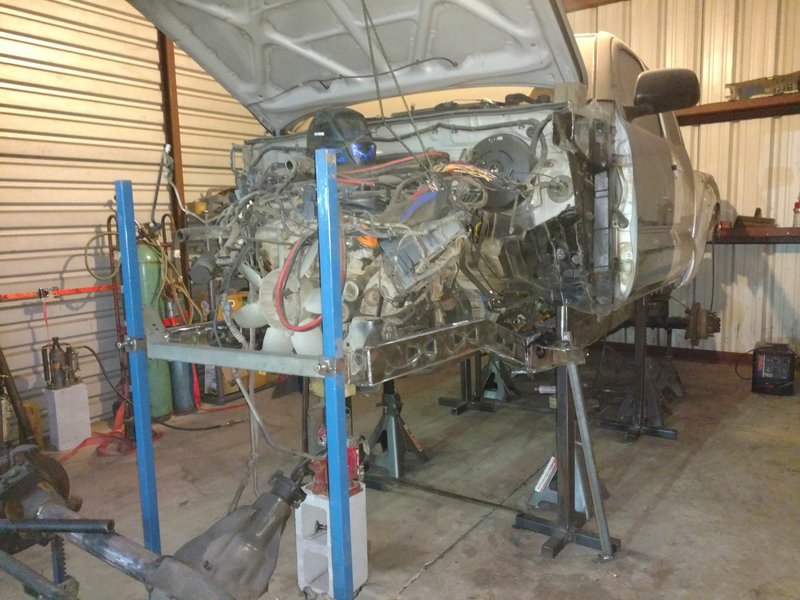

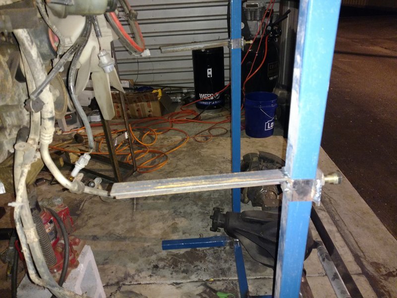

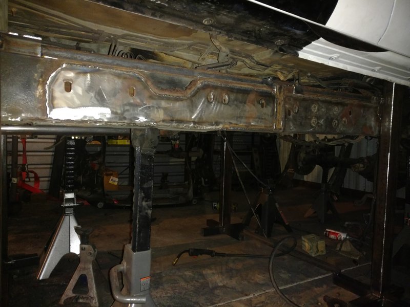

    So in an effort to get rid of this nasty ass frame, here's what I've done. I build a set of stands that hold the body 5" abouve the frame rails. The stands are butted up to the frame and cab mounts. I ran a piece of 1x1.5 angle iron along the top edge of the cab section of the frame. THis will give me a reference point for where the top of the frame is (currecntly 36.5" off the ground. The stands are welded together at the base (passenger to driver as well so they can't move). I'll pull a bunch of measurements before I start cutting so I can verify everything when it goes back together.
    I also built a stand out of scrap with adjustable arms to hold the core support mounts that I hacked uff the original frame. This sets the frame width at the front of the frame horns.
    Plan, as of now is to set the front frame sections we've already made to the appropriat height. Cut the cab section of frame out behind between the rear cab mounts and drop it out of the way. Using the "jig" I've constructed we'll replace that section of frame with more 2x4 box. Once its in place I'll weld in supports for it to the stands and can start working on replacing the rear of the frame
    Not the ideal solution but with some careful measuring and a little luck I think it'll work.

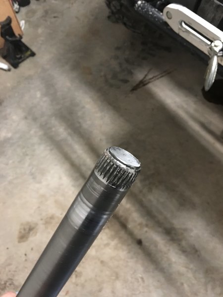

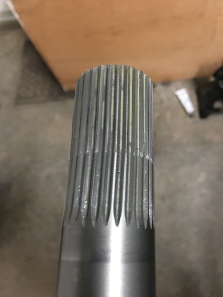

    Good thing I planned on upgrading to chromoly shafts cuz I just grenades a outer so hard it blew a hole through the hub and little piece keep falling out. Lol. Still made it home 3wheel drive on almost bald tires. 3#'s of air pressure for the win.

    Impressive!
    I still can't believe how long you wheeled with that factory stuff, considering the amount of abuse you have put those axles through :D
    Never met anybody that got so much out of stock D60 shafts and big tires for as long as you did.

    yup i got lucky and it worked too because i just barely got the money together to order the Chromo kit. could have gone cheaper and got usa standard stuff without the super joints but why cut corners now?
