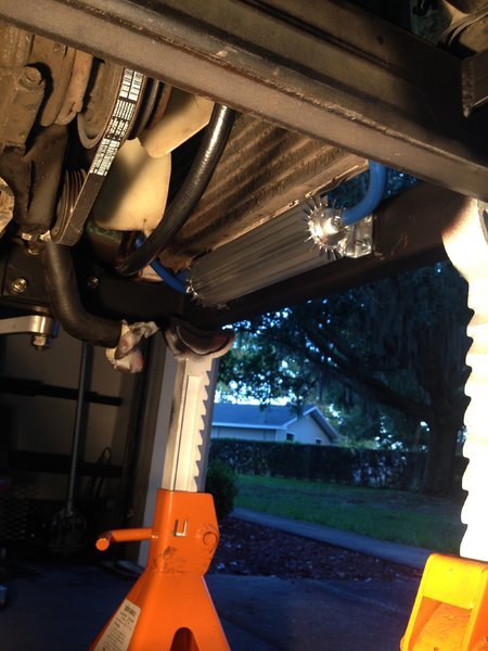

    So im looking at buying a heatsink single pass powersteering cooler, what size have people bought and where is it mounted?

    12" maybe? I don't remember exactly. But mounted mine on the front crossmember. The radiator is out in the pic but the radiator sits perfectly behind it.

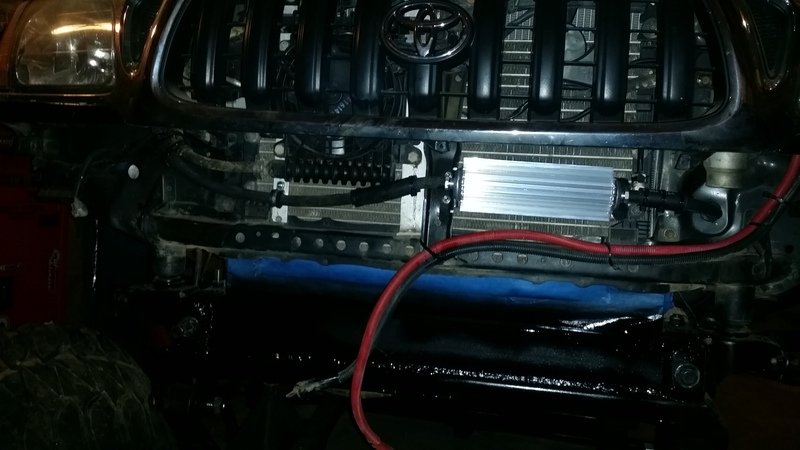

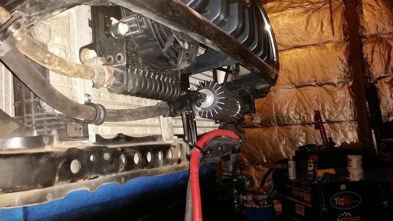

    Im running the 10" model, seems alot of the more common models are much larger.
    Thought I read somewhere it needed to be above the steering box, but below the reservoir to avoid air pockets. Can't seem to find that info though, may or may not be.

    Mines in the same location as allenfabs roughly. 12" derale, works great. Would recommend a longer one if you can fit it though, that fucker can get hot.
