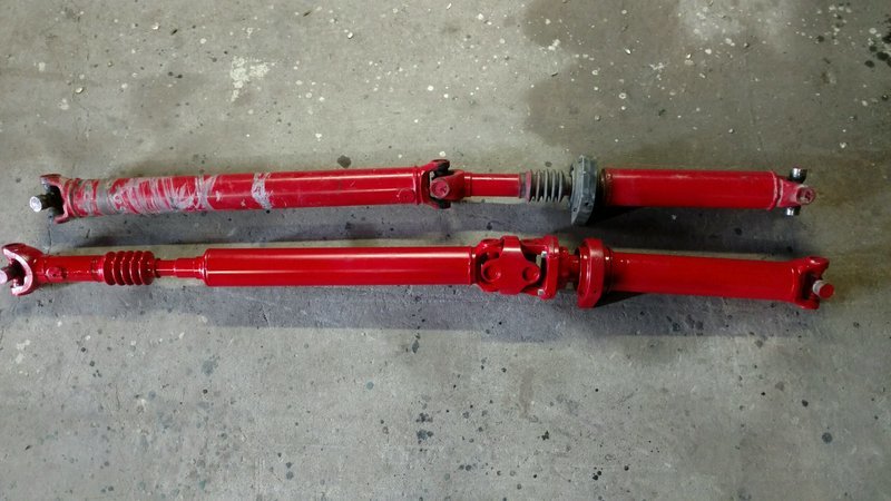

    I bought the trail gear electric sensor conversion and adapted it to the atlas cable drive gear. It was fairly simple to do.

    In the picture of the two drive lines the lower one is what I'm running now the first one was just a revised 92 f350 drive line but the new one with CVworks so much better.
