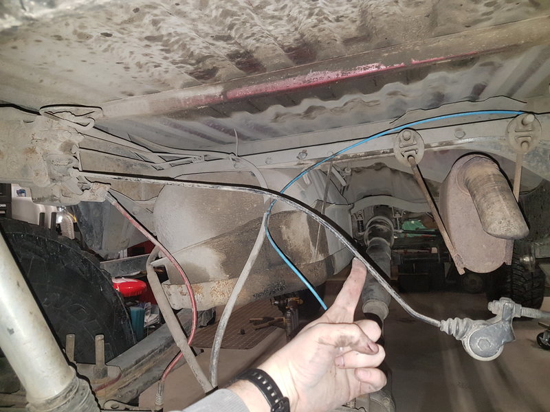

    Not the best picture ....but you almost already have all the parts you need.
    I took the factory eyelet on the axle side, took a die to the same factory thread pitch and used that to be an adjustable bpv.
    All I needed were two nuts iirc (10mm x 1.25 or 1.50) and a small metal L bracket (bolts to frame-side bpv) with 3 holes drilled.
    Loosen both nuts, thread top nut up or down, then tighten bottom nut.

    Nice. I might do that instead of a manual bpsv if I notice a positive effect. Just zip tied it for now.

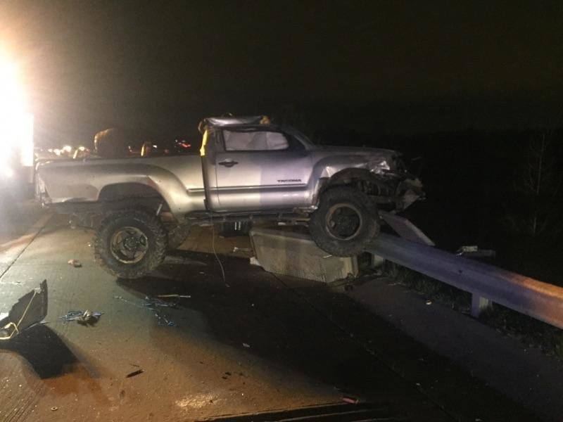

    Might be joining the sas/ buggy community sooner than I expected...
    Nate87 likes this.

    Flex shot!
    Mothman[QUOTED] and Nate87 like this.

    Ouch! Hope no one was hurt! Regular cab will be awesome with SAS.

    Walked away without a scratch. It'll be more of a firewall buggy since the roof is pretty caved in and the cab is fucked.
