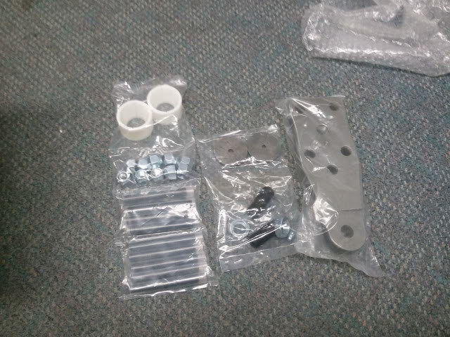

    And just to stay on topic...got some high steer arms on the way...went ebay for them...http://www.ebay.com/itm/DANA-60-CRO...Parts_Accessories&hash=item25780d9052&vxp=mtr
    Chassis Unlimited is a new player in the game, seems like a nice product, made is USA (if that matters to you) and cheaper than all the alternatives such as Ballistic and ECGS. Springless conversion and still includes all new ARP studs and cone nuts etc.
    Went with reamed for 1TON GM TRE's as well, just dont want to be replacing worn out heims all the time!

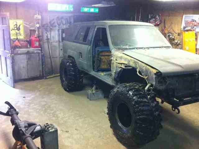

    Just the norm skids, sliders, & 35's
    Got some 18/39.5R15 boggers
    Needless to say I have a lot of trimming to do.

    Yeah, I'd say so. :cool: Nice, man. You still going with a 44 up front??? :eek:
    That sucks.... Why do you need highsteer arms though? Just to keep the tierod out of the rocks and obstacles? I thought that was for leaf sprung set-ups. :notsure:

    Keeps everything out of the rocks, also allows full crossover steering instead of a y-link which will reduce bump steer by having closer length draglink and panhard...
