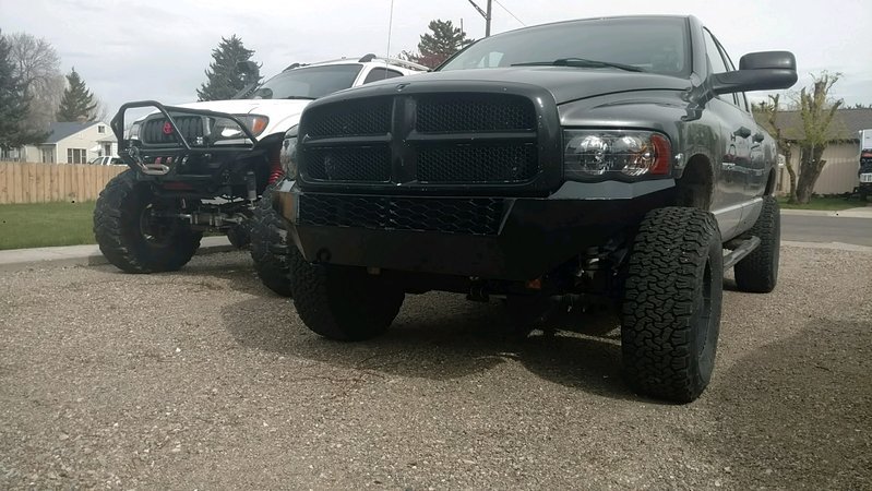

    Since I have a new tow rig figured I'd build it a new bumper. Kinda like my old one.

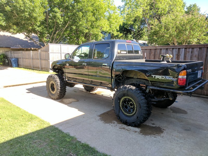

    Thanks. I got the last two wheels done this weekend. Still need to trim a little metal, but I like the end product.
    The tires are smooth until about 55 and then it starts shaking. I need to add a couple ounces of dyna beads to each to see if I can smooth it out.

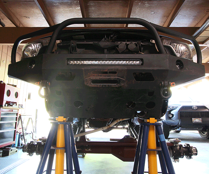

    Getting there... slowly. Don't mind the PVC panhard.

    Nice! Love the animation. Instead of posting multiple pics we can just see how the axle cycles in real time :D
    How wide if your axle again? As you might have realized already...the wider the axle the easier it is to fit things under there lol

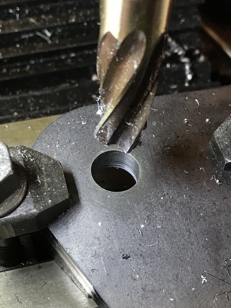

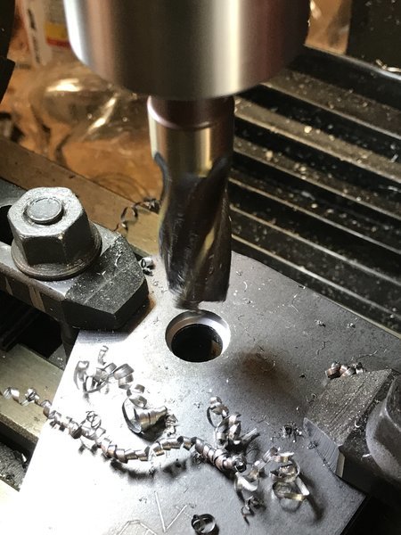

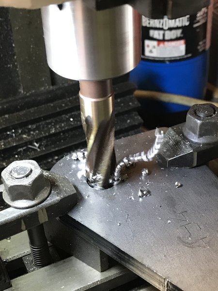

    Dunno if you guys have heard of this or not, but wanted to share the secret to drilling perfectly round holes. I know a lot of machinists that never heard of these, but they are called core drills. Only made to enlarge holes. It's like a combination of a reamer and drill. This one is 4 flutes, but bigger ones will have more.
    Going from an existing 1/2" hole to 5/8" is pretty tough on a normal 2 flute drill, even on a press, but the multi flutes makes it easy and keeps it centered and does not require a lot of power. This is just a cheap bench top milling machine.
    Makes beautiful chips. This is a Barnes ultra 100 bracket I'm using to make my own frame side panhard bracket.IMG_1545.jpg
    Super clean and round holes.
    Will work on a hand drill, just need a steady hand, low rpm, and a little oil if you want your drill to last.

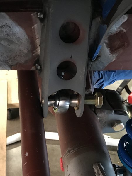

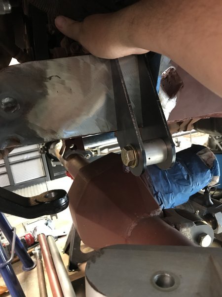

    Can see here that the frame side panhard bracket is ridiculously wide, and at full turn towards the drivers side, with passenger tire fully drooped, and drivers side stuffed, the 1.5" tie rod hits it. If I push the axle more forward, the tie rod will hit the pitman. So I'm making a new, more narrow bracket.
    But really, the AP kit will work if you don't mind 6-8" of lift, but I'm trying to keep this really low.

    Hahaha But all pro swears it works. Hopefully the revamped version actually works but I highly doubt it.

    Totally. If you look at the black Betty build, that's a 4cyl, and they changed the motor mounts, and may have even raised the engine a little. I'd like to see them do a detailed build thread with lots of pics on a V6 2nd gen using their kit without modifying it, according to their directions, and without raising up the engine.

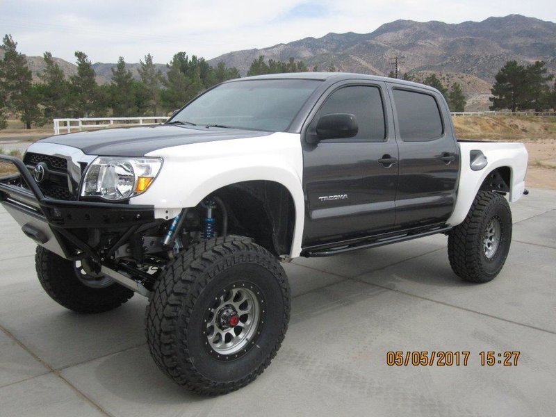

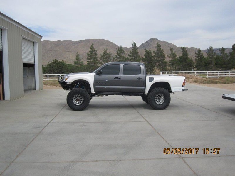

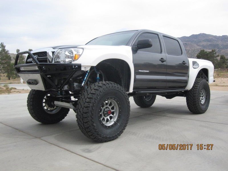

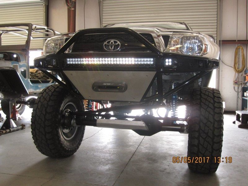

    SAS is complete... Just wanted to share for those who have not seen the build. Be easy on my guys I'm old and fragile:hattip: Oh and @1999RegCab Sorry for the bling.:D Anyways my (signature page) has detailed list and pictures for anyone interested.

    Man, congrats! It loos great! It is really a great feeling when you finally see the rig on all fours. That is one clean build, I really like it. You got a ton of clearance from that front bumper.
    Did you guys get a chance to stretch her legs yet? :D
    So after the front axle got built hub-to-hub, what was the final measurement? Is it equal or comparable to full-width?
    BTW...everybody gotta have a little bling here and there :D

    Thanks for the support, it has been a huge learning experience that broke the bank. The truck was cycled by my builder and I told my son to drive it straight home..haha I get home at the end of this month and will stretch her out for the first time.:headbang: Can't recall on the total axle width hub-to-hub, I'll check when I tear her down to paint the frame.:cheers:
