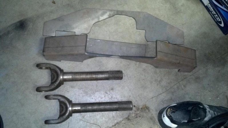

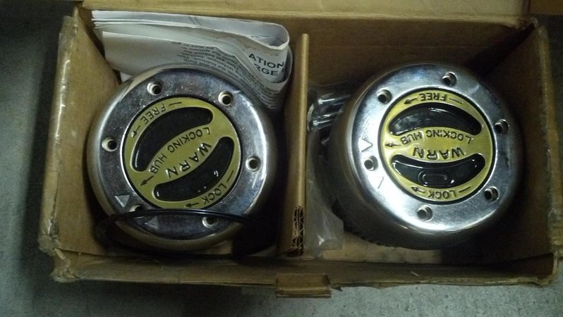

    Came up on the deal of the century :eek: Guess my truck will be swapped sooner than later :rolleyes: Specs:
    87 F350 HP D60
    NIB 5.38 gears with master install kit
    35 spline chromo stub axles
    NIB 35 spline Warn Premium hubs
    Passenger side hi-steer arm
    NIB king pin rebuild kit
    Complete Chevy outers with brakes
    Ruff Stuff diff cover
    Truss
    Plans: 3/4 ton brakes, unsure on locker at the moment, driver side hi-steer arm
    SRW 14 bolt minus carrier
    Disc brakes with El Dorado calipers (probably swapping to 3/4 ton brake setup like the front)
    High Angle Driveline 1410 yoke
    Plans: Shave, 5.38's, ARB locker or Detroit if I can find a carrier
    Also picking up a set of 38" Toyo MT's from the same guy. I think 40's and 5.38's with my automatic won't do so well on the street. 37's would be ideal but I don't want that small of a tire with the big 14 bolt out back.
