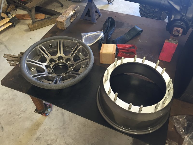

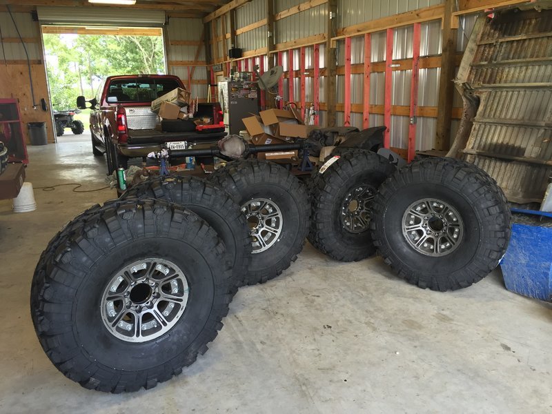

    I cleaned up my 14B and assembled my wheels over the weekend. I'm not going to be able to tear into the truck until mid July due to the day job, but at least I can get something done.

    I like those wheels!

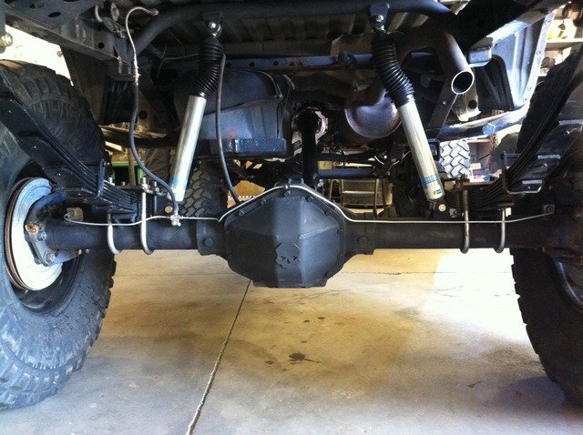

    Don't have any new pics but this one shows the added clearance. Can almost fit a 5 gallon bucket under the rear axle :D (with the shave and 40"s)
    345BF92C-9E96-4EBB-87F7-422C9BCB6564_zps_2900bb76769c3860d74827e7834f33b4a8b13ac7.jpg
    RCTOY probably has more clearance than that even though his 14bolt does not have the shave because he is running 42"s. That's a another good chunk of clearance.

    Nice wheel/tire combo. How was it installing those wheels?

    So much better with the drums gone though. The newer slip on drums were cake to remove though. :D
    I had one wheel give me shit, but the rest were done in 15 min each with the help of another set of hands.

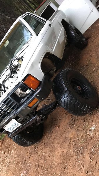

    IMG_8583.jpg Sas'd this 85 2wd Toyota. Swapping a Chevy vortex 4.3l v6 into it, just looking for a w56 trans and top shift t case.

    Yea those drum brakes are huge and heavy. So I assume you are doing the disk brake conversion.
    It sounds like the wheels are not really a PITA to deal with like other bead locks are.
    It reminds me a little bit of the military style bead locks
