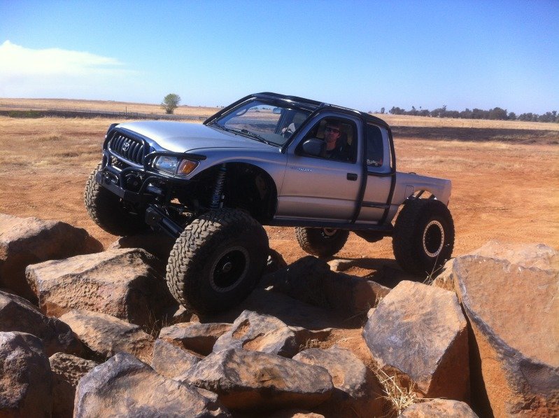

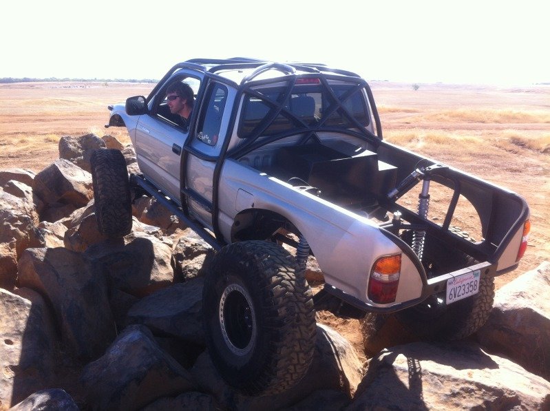

    Here is a pic compared to the fj
    This is the same spot as the first pic i posted but Tacoma with and 3.75bs on 15/8 wheels.

    That Tacoma is well built!
