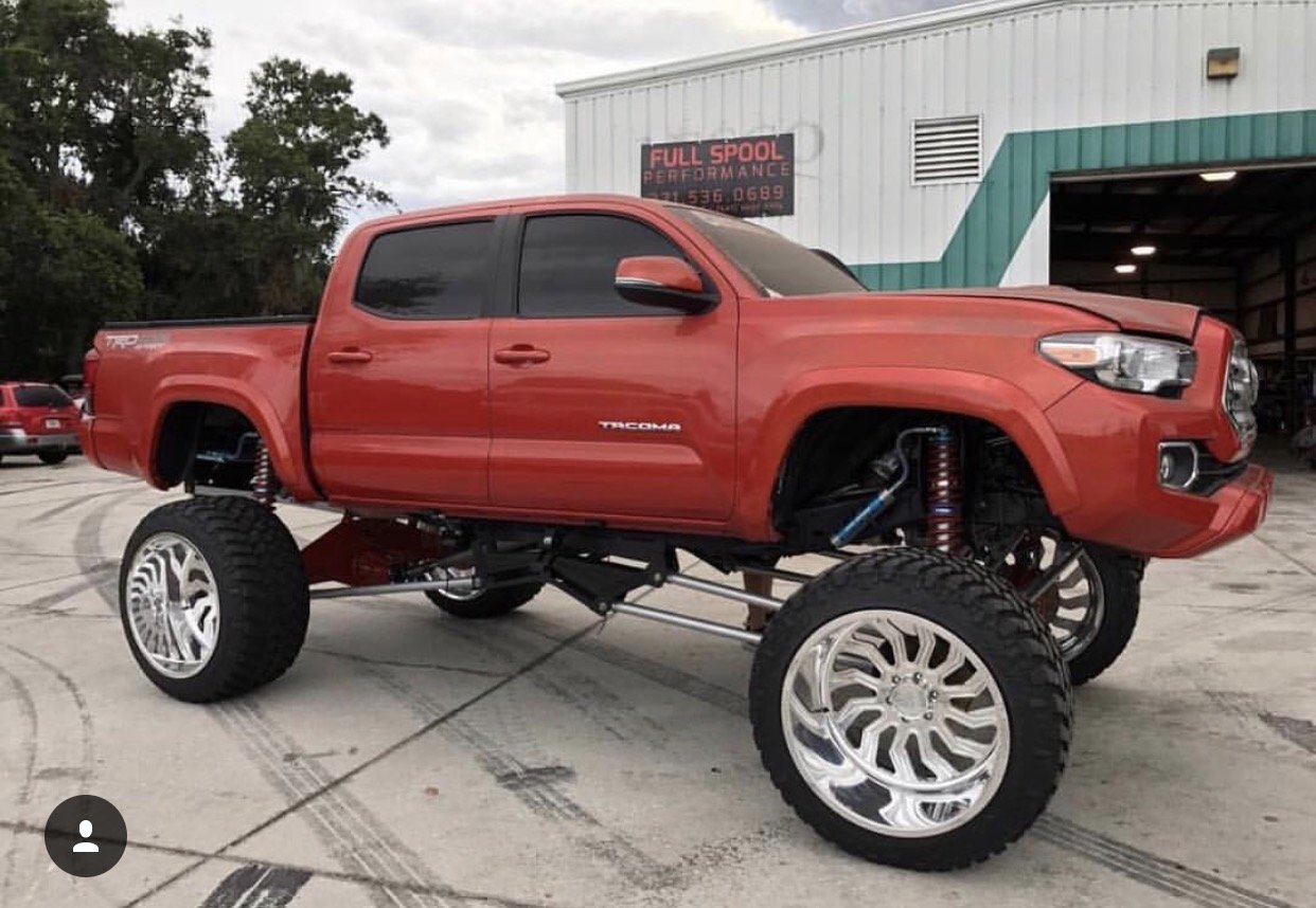

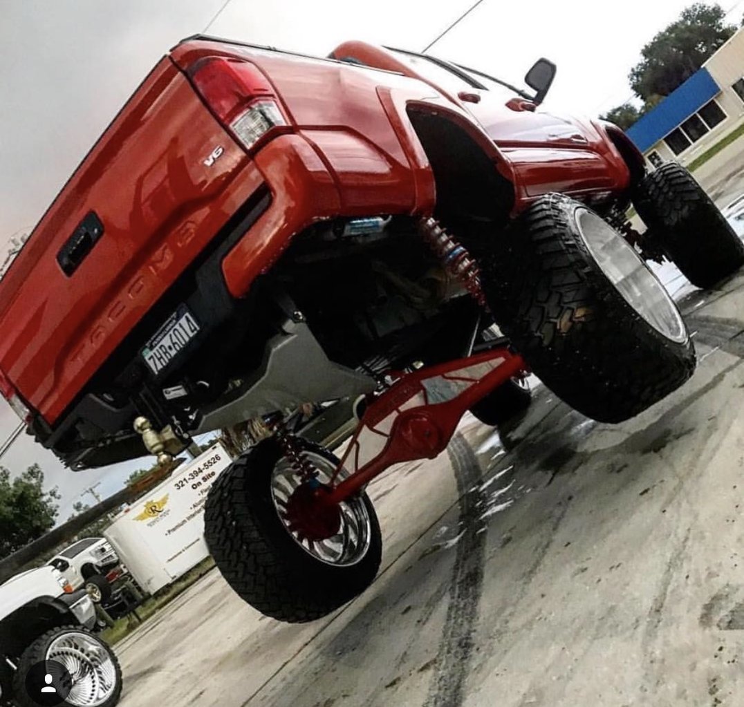

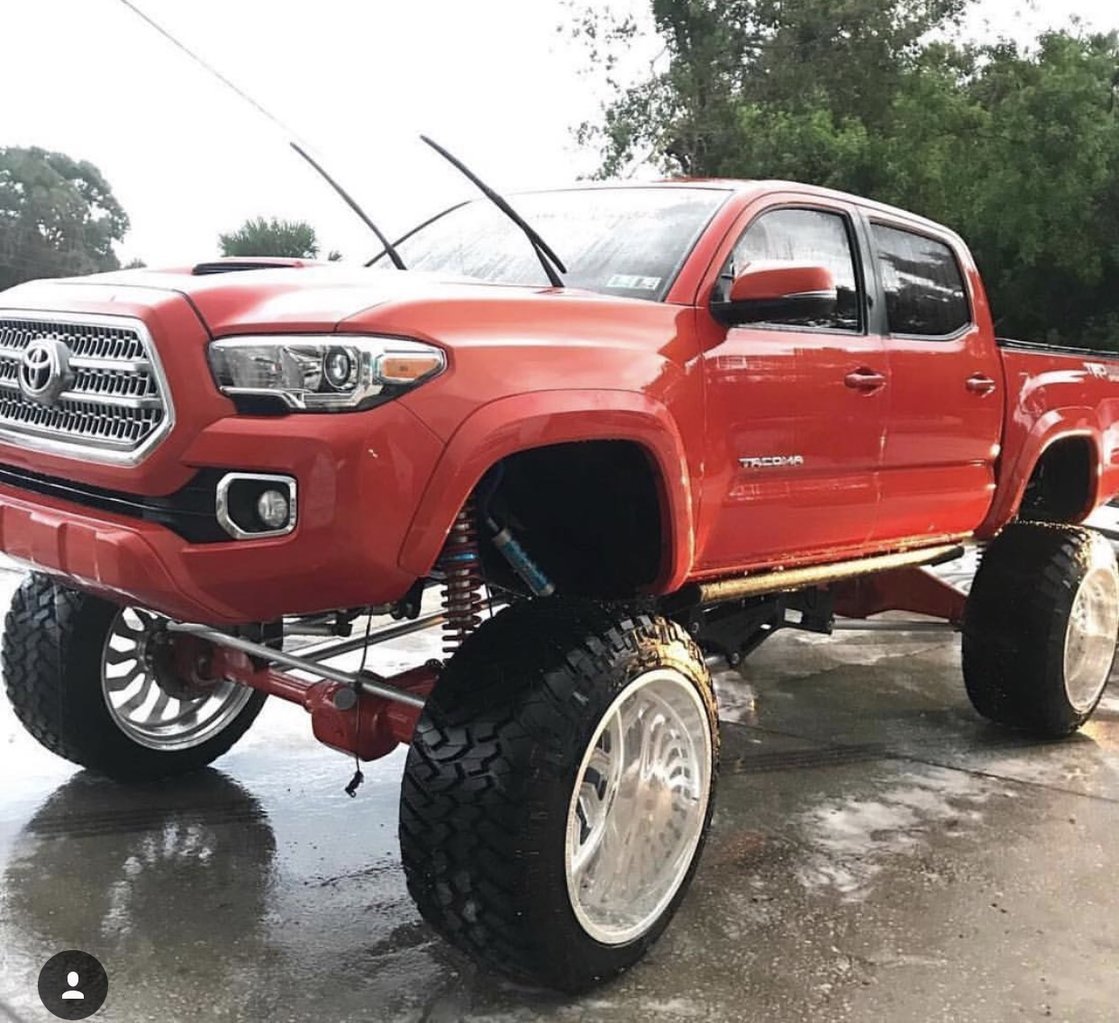

    You guys are doing it wrong :bored:
    So glad it's not a hawaii truck :D
    Nickel and 4Running Daily like this.
