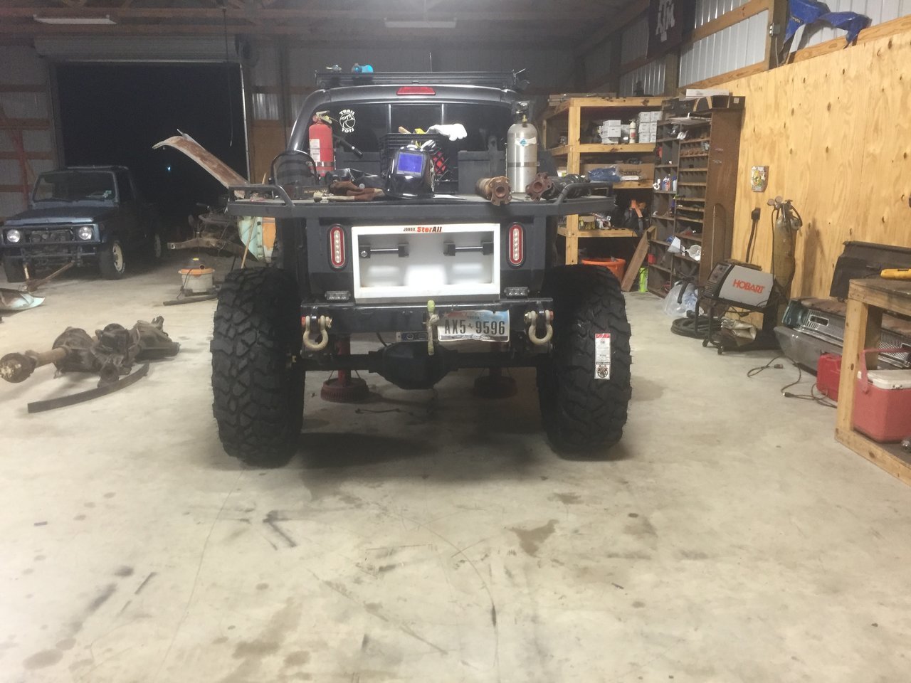

    Tacked the 14Bolt in finally. Time to flip her around and start gutting the ifs.

    Pulled all of the IFS last weekend. Tomorrow starts the cutting and grinding. Yay!

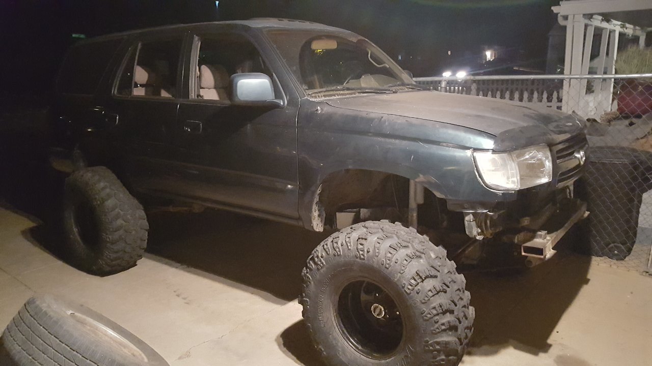

    20170827_204029.jpgRolled it out if the garage for the 1st time in 2 months.
