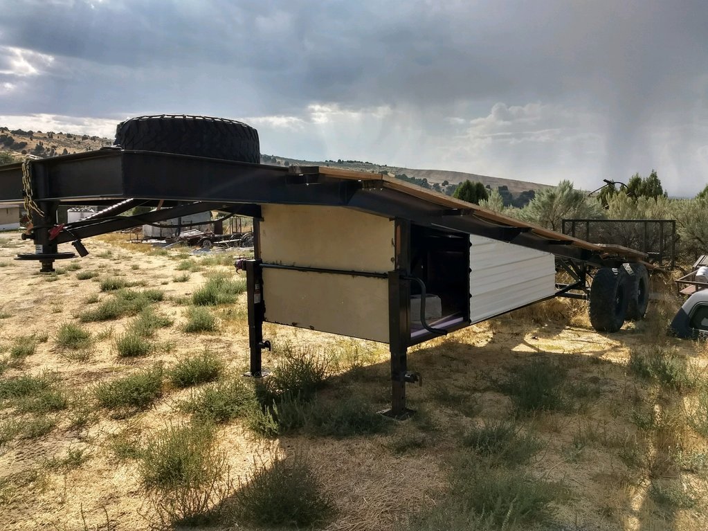

    Got this done to my car trailer. No more tent for me

    I've seriously contemplated a gooseneck with a slide in down the road. Nice alternative!

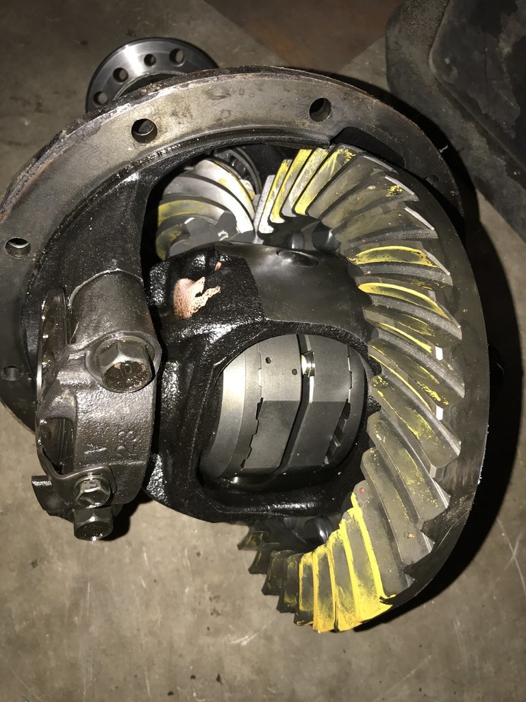

    Stuff happened in the garage today here. Should be installing my new 9.5" 5.29 third with a Spartan and rear axle this week.

    Make sure you grind that drain plug off and use some bolts on the bottom two stud holes.
