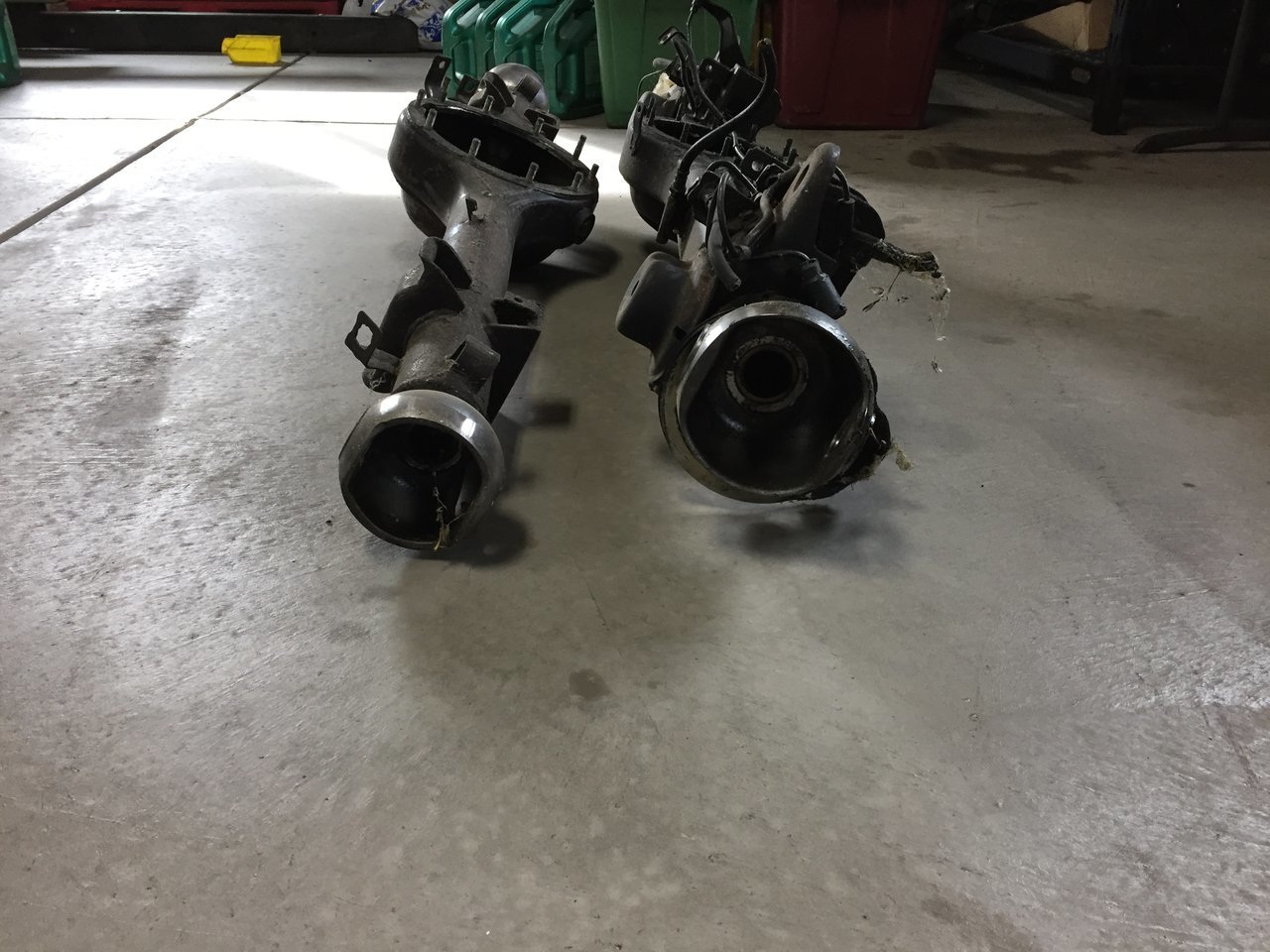

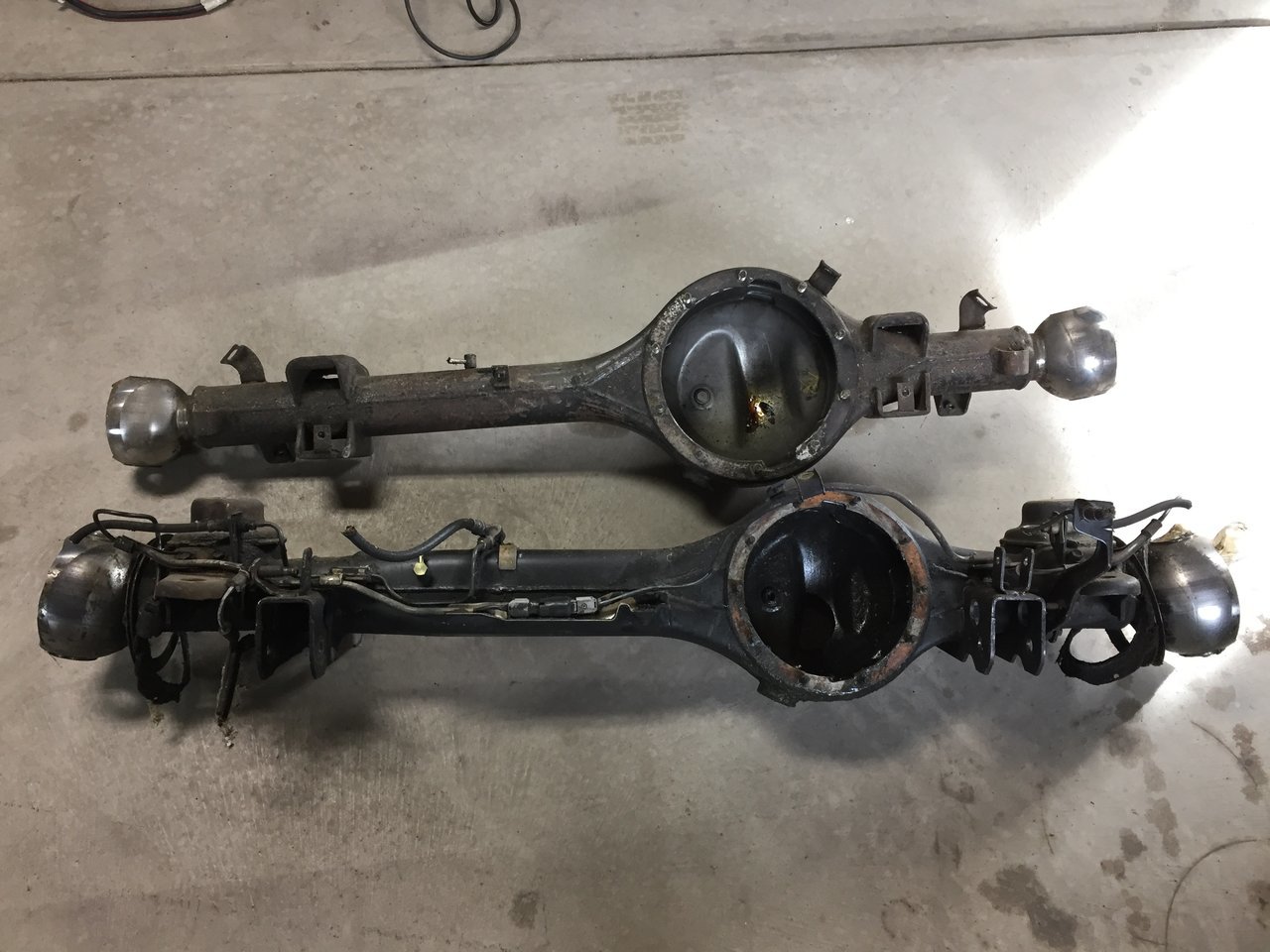

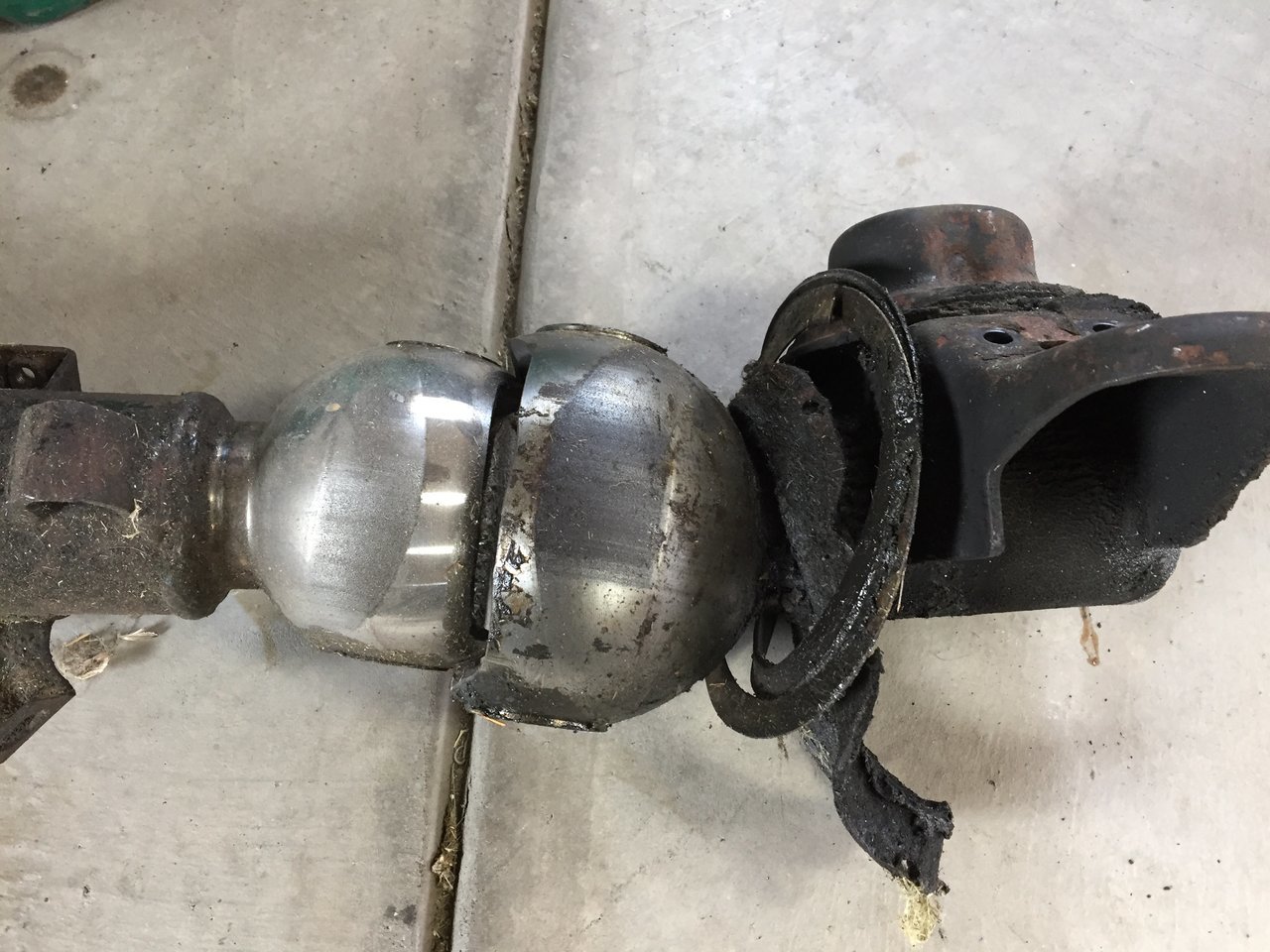

    the bigger birfields aren't really the advantage, with chromos most people are breaking shafts or R&P before birfs. The advantage is the bigger knuckles with wider trunnion spacing puts less stress on the trunnion bearings, also wider bolt pattern on the steering knuckles.
    80 axle vs 60 axle

    first time I see a pic comparison between those two.
    The balls are certainly much bigger on the 80 :laughing:

    Because the 80 axle is HP 8" instead of a 9.5" like the 60/62. The 80 birfs are way stronger than mini truck stuff.
    Trunion bearing eliminators from TG fix any of the issues from stock trunion bearings...I literally never think about my trunions until I'm taking apart a knuckle and remember how much easier they are than actual bearings. They are great
