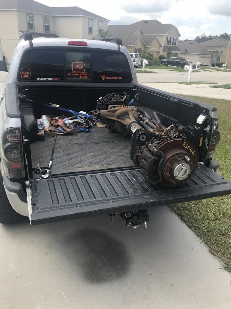

    And so it begins. A very slow beginning.
    $477 with core and taxes. Mileage is unknown.

    That's a good price. Stole my front and rear for $700 but had to drive for 8 hrs haha

    Rear will come eventually. Tag says 05 f250 Harley-Davidson edition from the yard.
