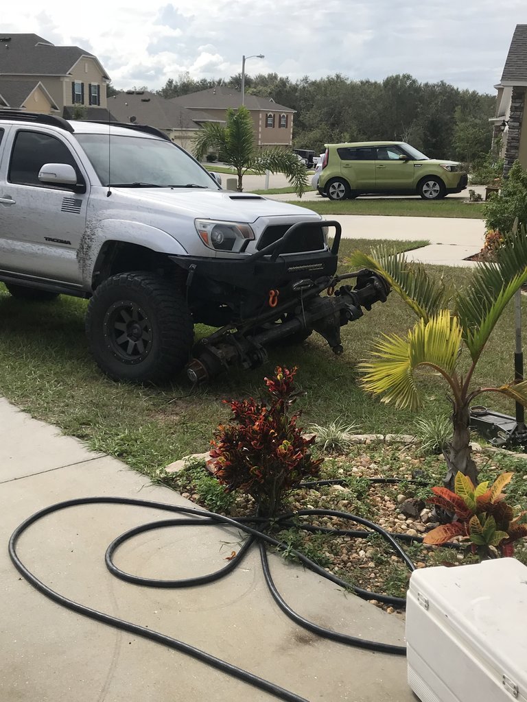

    1997 t4r has super duty axles, 5.13s locked front and rear. 3 link front with 14" kings. Rear 63s.
    This will help keep weight down low. Me and a buddy couldn’t move it. I’m 6’1” 265. And he is maybe 180. I had to use the truck to move it out of the front yard and into the garage.
    Sucked it up with the winch and drove it in.
    jubei and Acerwin like this.

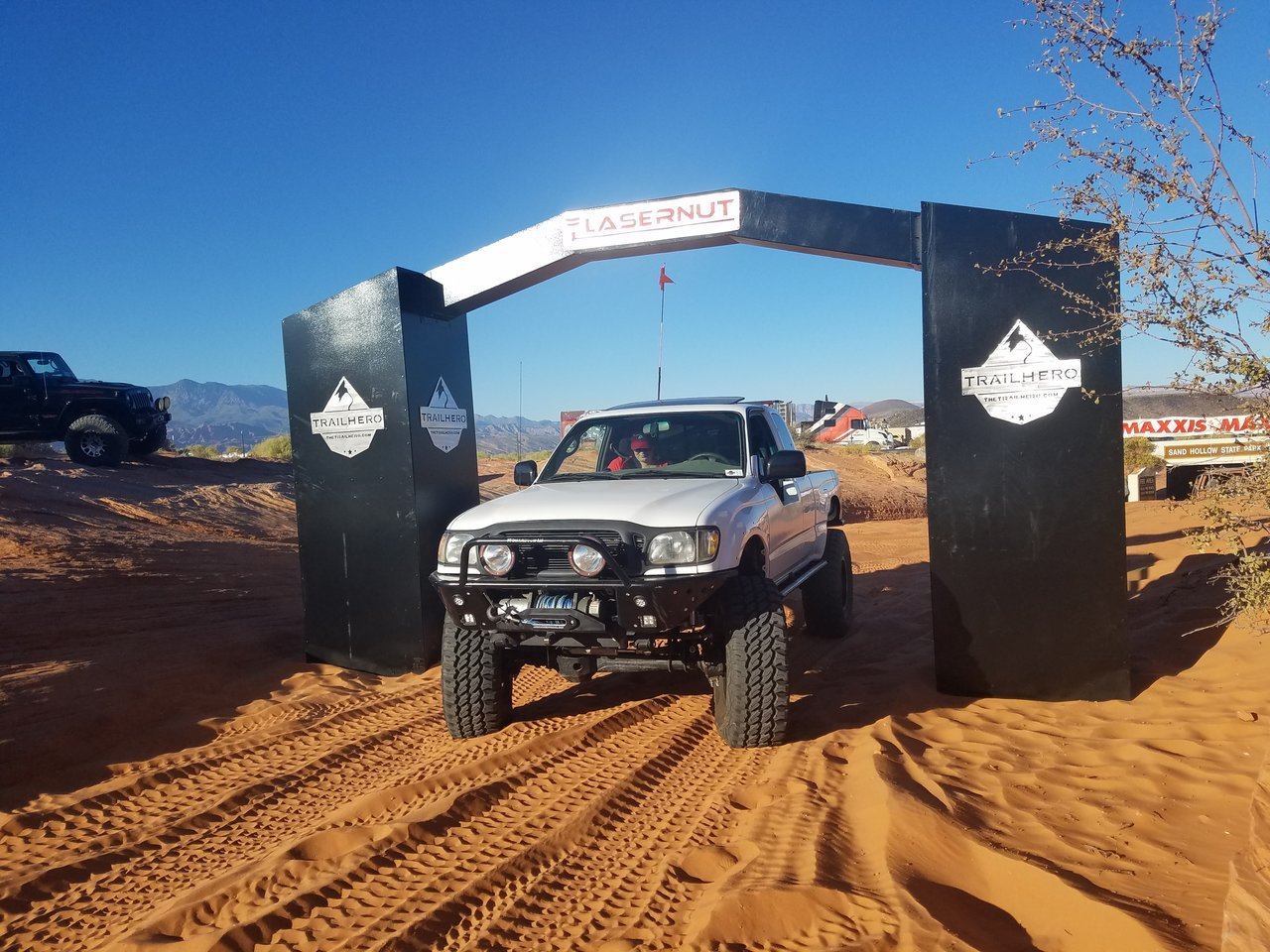

    I've seen the videos for that event. It looks like a great event.
    That's a nice pic of your truck BTW :thumbsup: How do you like those tires? On a 40" they are the cheapest you can find and I was thinking about getting those next time.
