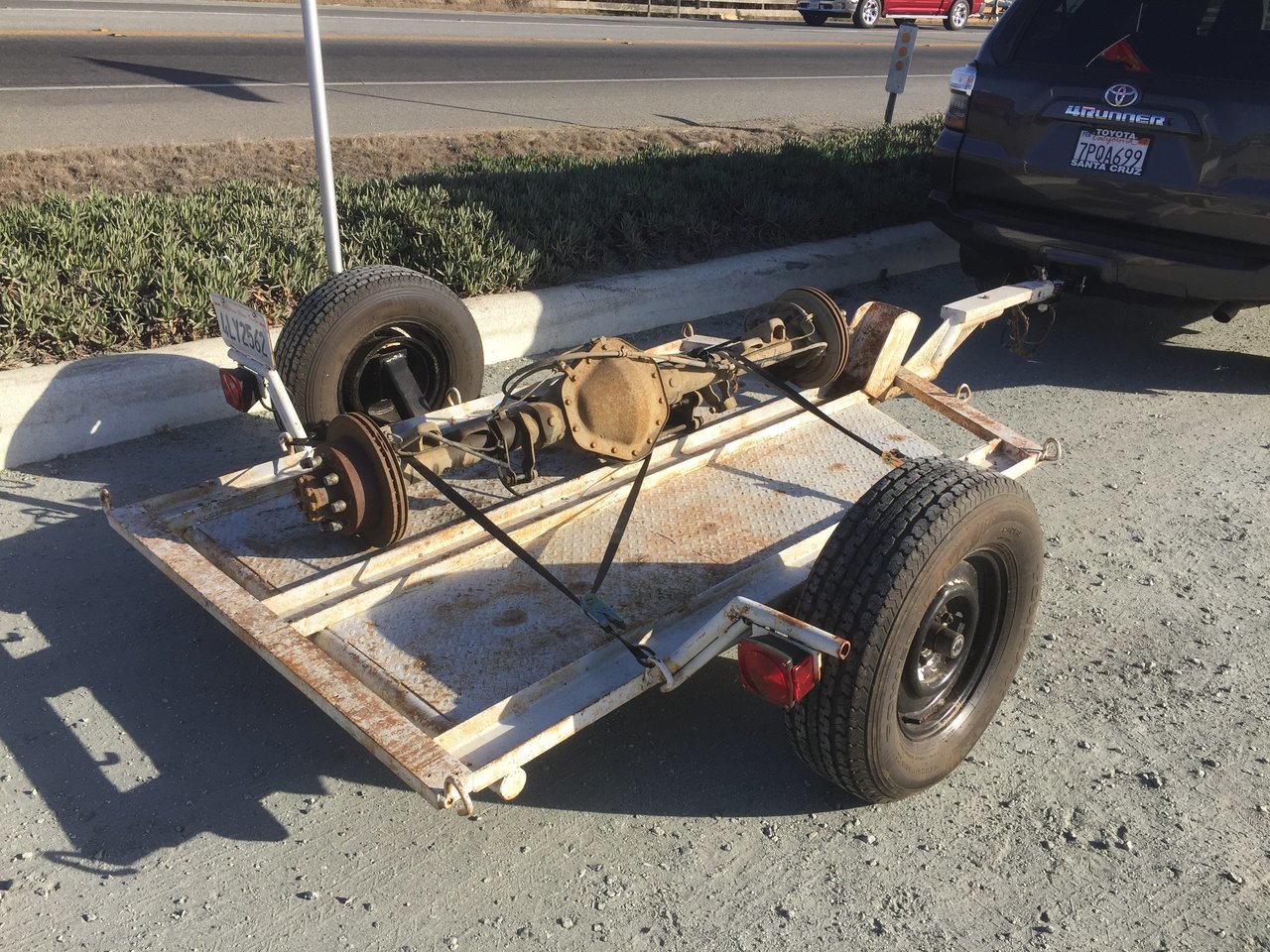

    I was driving the T4R around today, and this 14 Bolt just fell onto the trailer...
    Turns out I lucked out and it happened to be an 05 2500HD axle with Factory Disc Brakes, 4.10's and a locker. Freshly pulled from its donor this morning.
    I couldn't pass it up, 1/2 the price of the wrecking yards and it came with calipers and rotors.

    Same I axle I got. Came with factory disk brakes as well...just a few years older than yours.
    Didn't have issues matching the wheel bolt patterns since my front D60 is older and it has the 8 6.5 bolt pattern.

    These axles are the ones to get for the 99% of people that want rear discs but also want a parking brake. OEM drum in disc setup. Aftermarket solutions (eldorado calipers) suck.
    Do you know what locker is in it?
    There's probably enough meat on the hub to redrill them, downside is you also have to drill the rotors which are a wear item. I'm pretty sure the super 60 is wider, so easiest solution is to run an adapter spacer on the rear.

    Pretty sure a Gov-Bomb. I'm hoping I can get $75 for the locker and 4.10's then I need to source an open carrier so I can run a Detroit or a Grizzly locker. I have a Grizzly in my other 14 Bolt, and it has taken a beating and still works flawless.

    It's a good choice. The locker is unfortunately a gov-bomb. I doubt it's even worth selling.
    The newer ones are. After American Axle Manufacturing picked up the 14 Bolt design it became the "AAM 1050". All the bolts and wheel studs are metric.
    I ended up converting the 14B 14mm wheel studs to match the 9/16"s on the Ford D60. I shared the specs/info here (WY_Taco on Pirate)
    http://www.pirate4x4.com/forum/gene...ont-wheel-stud-conversion-2.html#post21967481
    Easiest way you can tell if it's a new 14B is the ribs on the diff.
    When I bought it
    Under the truck
    [​IMG]suspension by Jonathan Krajnak, on Flickr
    It's great that it has the disk brakes and e brake standard.
    Unfortunately there's less aftermarket support for the newer design. Also, you're stuck with mounting the calipers towards the front. Which means you have to bring the horizontal link separation in quite a bit to clear the large caliper housing.
