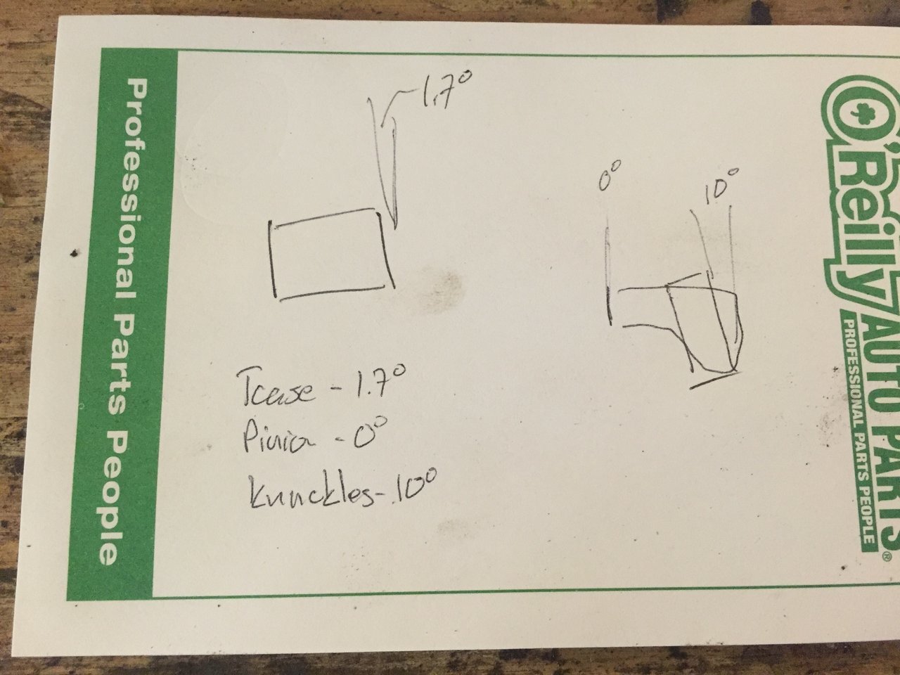

  18. Oct 16, 2017 at 5:04 PM
    #9438
    SMKYTXN
    SMKYTXN If it can't be overdone it's not worth doing Vendor
    Mar 11, 2011
    #52810
    14,040
    Nathan
    Houston
    11, 4dr, TRD Sport, 6sp
    DCFB
    Need some input on pinion angle. Here's where I stand.
    1.7degrees at the twas front output
    0 degrees at the pinion flange
    10 degrees of caster
    I have caster alignment bushing in the knuckles that are currently maxes out. So I can take 3.5 degrees of caster out with those if I need too.
    I'm planning on running single ujoints on the driveshaft.
    My thought is that I need to point the pinion up a degree or two. Thoughts?
  19. Oct 16, 2017 at 6:54 PM
    #9439
    slander
    slander Honorary Crawl Boi
    May 10, 2013
    #103909
    8,964
    Hickory, NC
    02 Tacoma, fixed with curse words.
    With single joints the pinion supposed to be perpendicular, right? Mines setup like that and I get minimal vibes, then again ive only went 20 or so with it in 4wd.
  20. Oct 16, 2017 at 6:55 PM
    #9440
    SMKYTXN
    Mar 11, 2011
    #52810
    14,040
    Nathan
    Houston
    DCFB
    Right, they should be parallel, but that puts the pinion pointing down. That doesn't make any sense to me. lol
