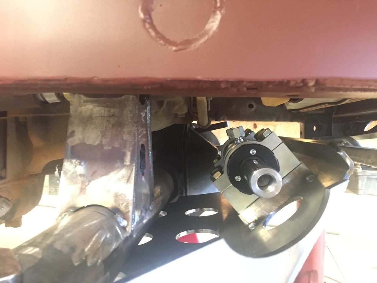

    i custom built my own. i welded part of the factory mount to the adapter plate that came with the atlas.

    4speed? I'm considering the 2spd with the 5.0 gears or a marlin dual with 4.7s. I have the A340F with 4.88s right now and it's too high for 37s. Any thoughts?

    I have an Atlas 4 speed and I'm just using the stock transmission mount (poly bushings though) but have started a mount that mounts to the atlas inspection plate on the bottom of the case. I really need to complete that....

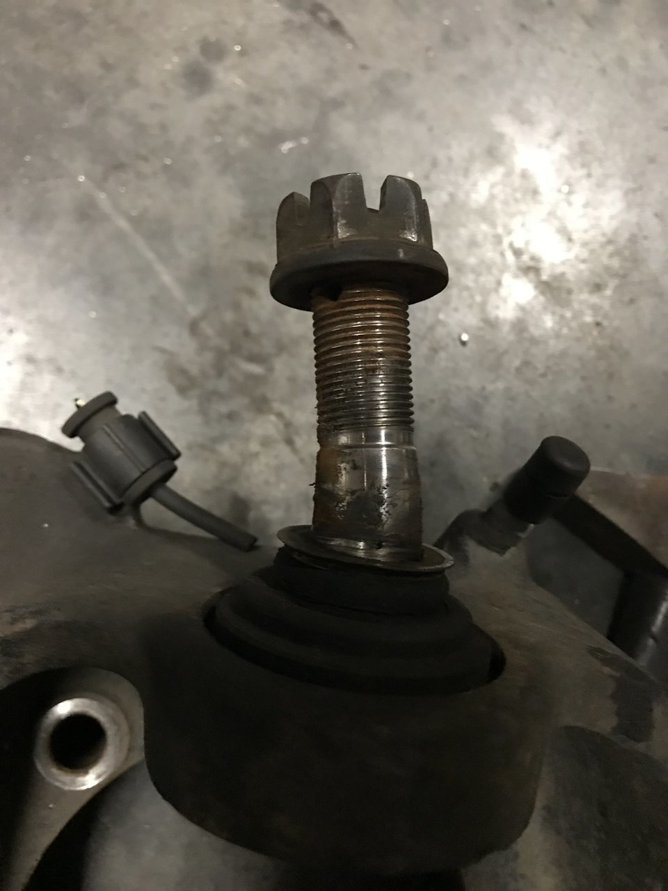

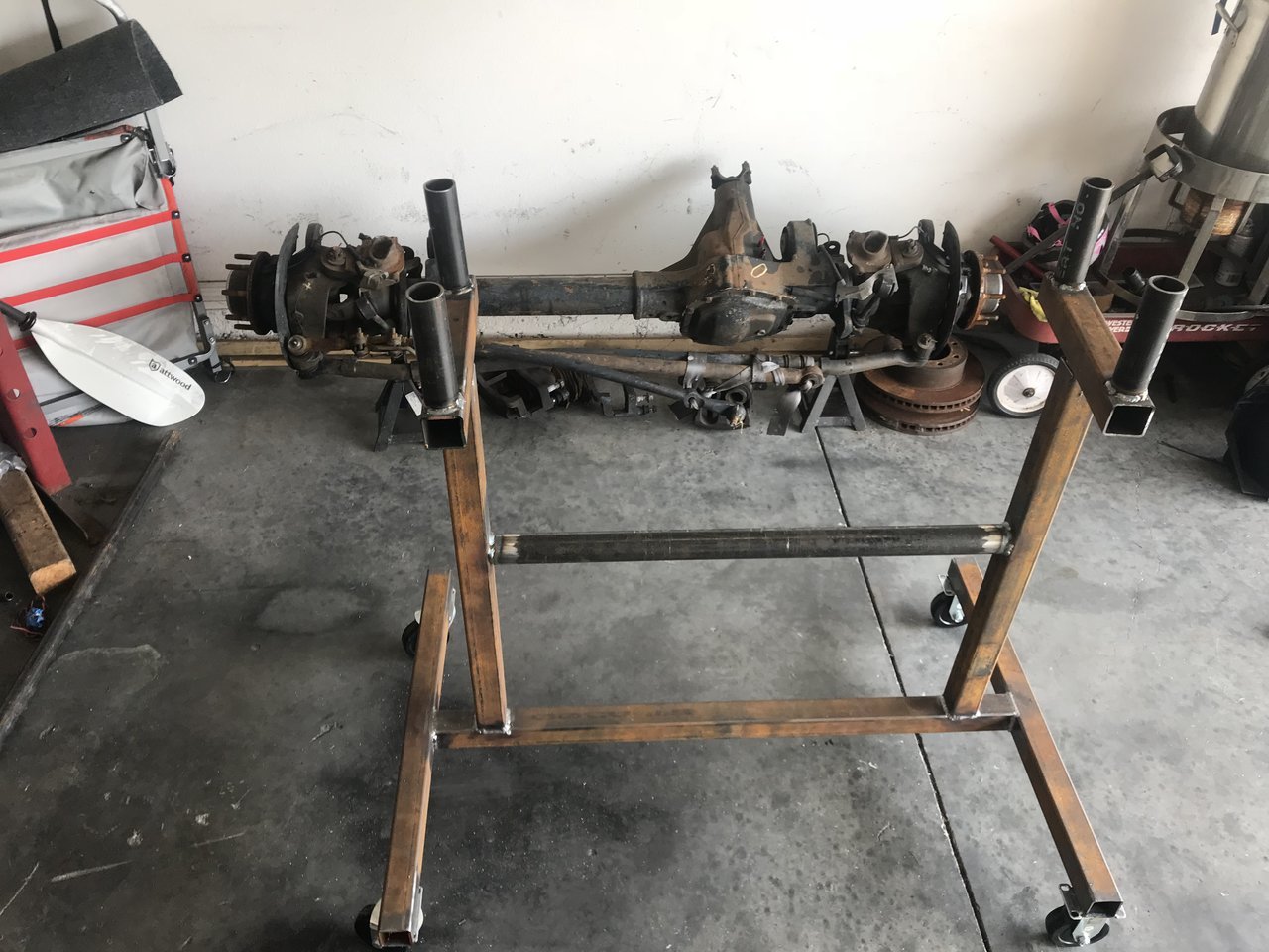

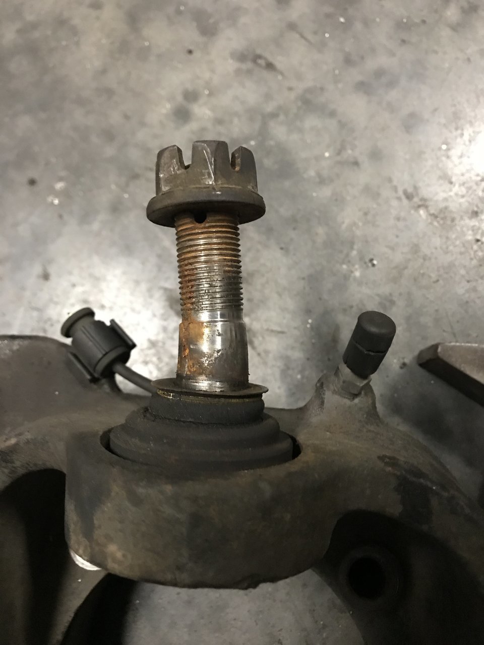

    Built a stand for the axle so I can start clean up. Upon removing the hubs and knuckle I find a bent upper ball joint. It was really loose and the lower ball joint is toast lots of slop. Once I get it tore down so I can get it on the stand I’ll check the tubes to make sure it’s not bent @allenfab

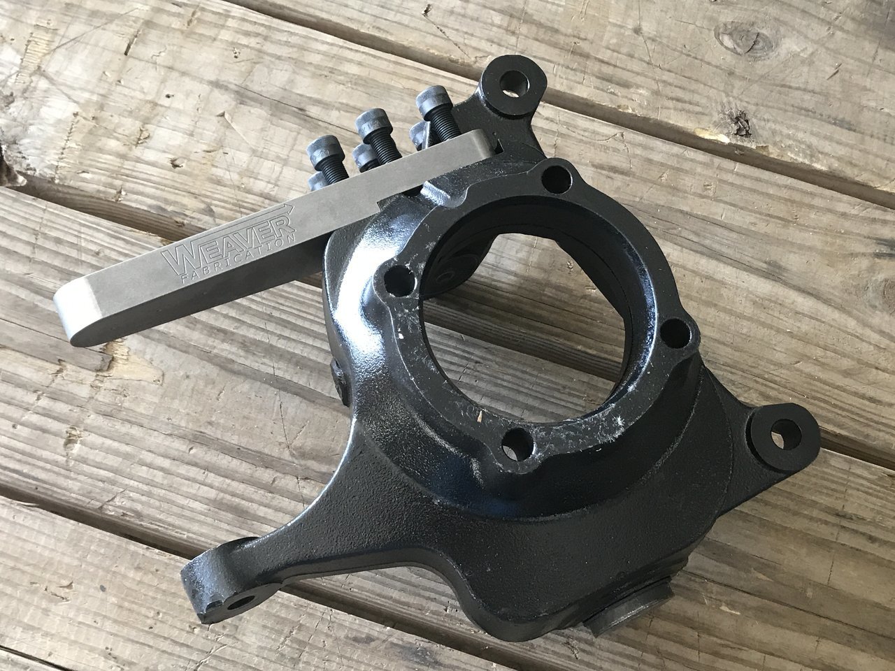

    Who do you guys suggest to get some knuckles machined, and if possible get high steer from same company? Or should I just get a set of Artic knuckles/high steer?

    Weaver fab. Great company and not to expensive. Here's mine
