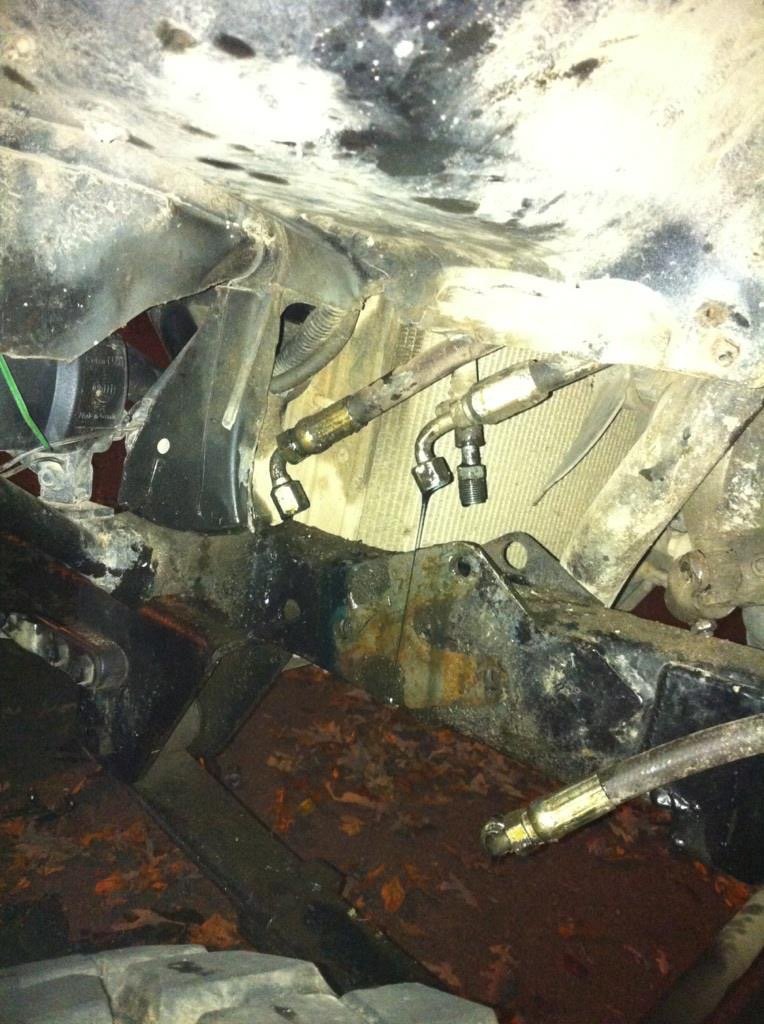

    I must of got lucky and got one of the last "3.4l" kits, did not had to modify anything, bolted right up with TGs bracket.
    Although I will say when it comes to the reservoir the difference between PSCs and TGs is miles apart. Have mounted both the PSC (mine) and the TG (sami buddy). PSC is nicely machined and has a serviceable internal spin on filter vs TG is literally a coke can with a stamped steel lid.
    Oh and of course spring for field serviceable fittings.

    Yup I need a project to web wheel on all winter lol!! I will probably get a psc resi and the tg bracket. I have field serviceable fittings and spare hose in my spare parts kit for wheeling, I have tons of those. My friends have all had good luck with surplus center Rams, so I'll probably go with one of those.

    I’ve had great luck with the full PSC assist setup I inherited on the truck. It bleeds easy and doesn’t have any jerky-ness on the highway. The only outside the box thing I’ve done is remake the brackets to lower the pump so the resi is higher above it to prevent starving on long uphill climbs.

    Okay so im really curious.. people who SAS usually use an IFS steering box or one off a mini truck or something of sorts right? Why does no one use a steering box off an 80 series land cruiser? Much bigger and stronger, and no need for hydro assist.

    You still need hydro assist with an 80 box. Usually people don't use them because they are expensive (cuz expo parts) and they are forward swing and can be a PITA to package in there.
    I used a forward swing box off a 78-79 f150 because the internet experts said you don't need hydro assist. My winter project: hydro assist.
    The forward swing box was a royal PITA to build around. Saying that it allowed me to narrow my frame super tight to the radiator.

    80 series sector shafts bring the suck too. Guys swap them out for 105 series sector shafts because the 80 sector shafts break right above the pitman arm.
