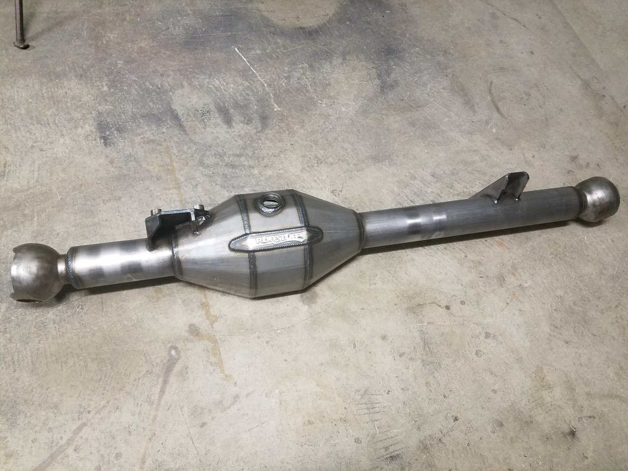

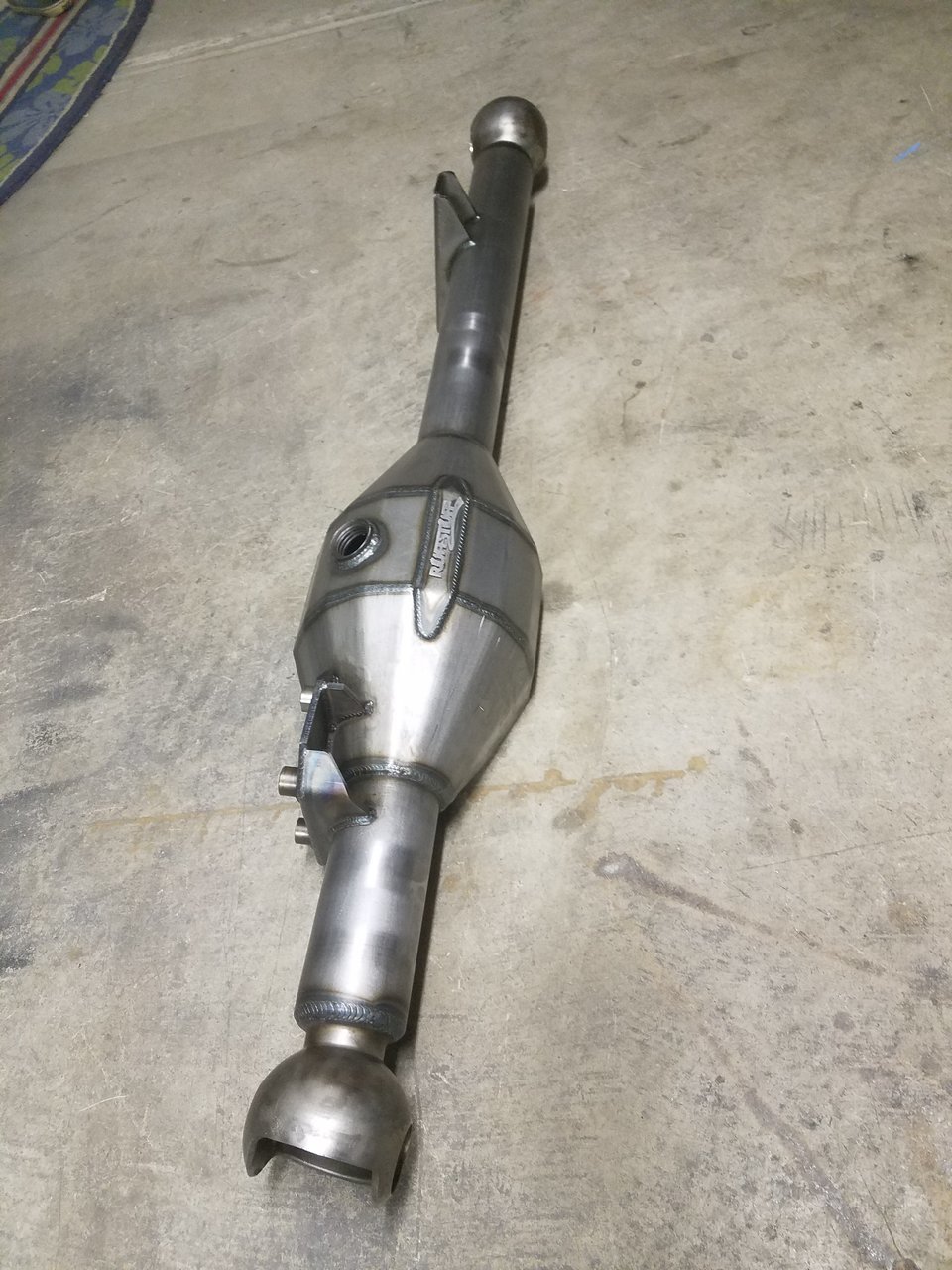

  20. Nov 16, 2017 at 8:59 AM
    #9580
    stumbles
    stumbles 1 eye
    Aug 18, 2014
    #136442
    4,391
    bryan
    mesa
    2002 White Double Cab
    I believe this is the front.
