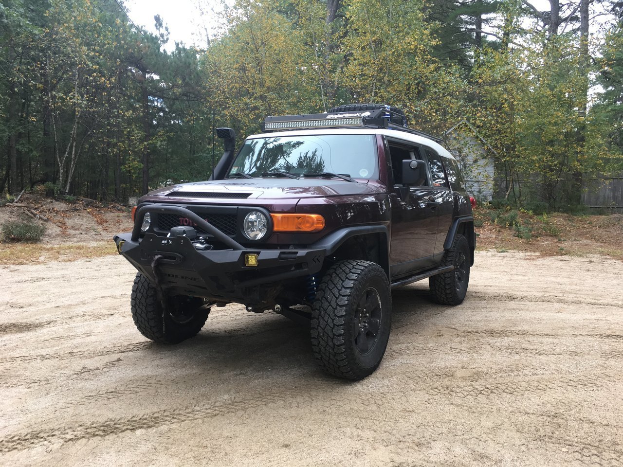

    I'm just here to drool...
    doorsidedown likes this.

    And the reason why you posted a pic of your IFS rig on the SAS folder is.......? :D
    Are you planning to :sawzall:your rig to SAS it? There's a few FJs around with straight axles up front. They look so bad ass. Be the next one!
    cmack likes this.
