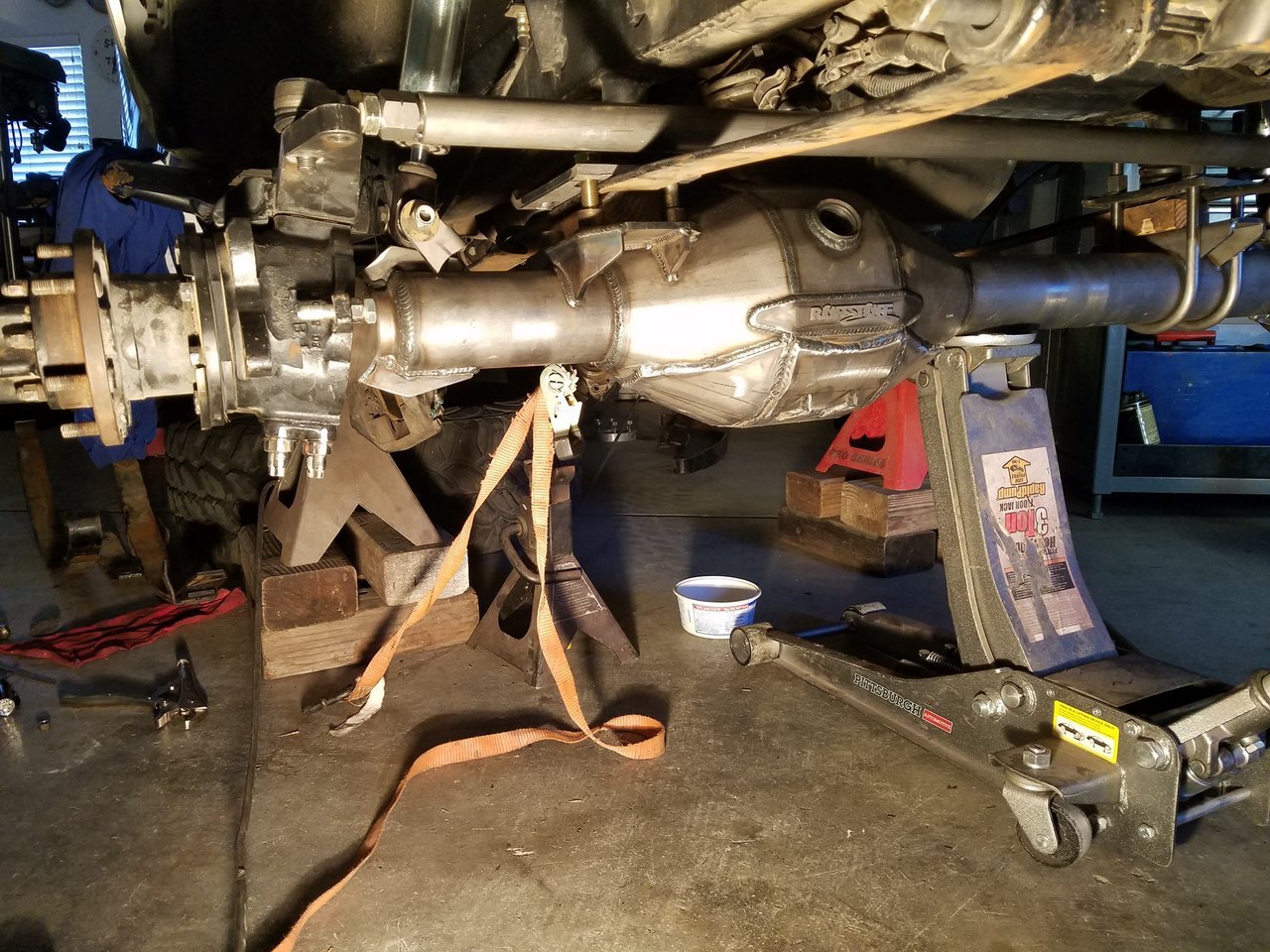

    Got the axle shafts together. Hopefully have it done next week.

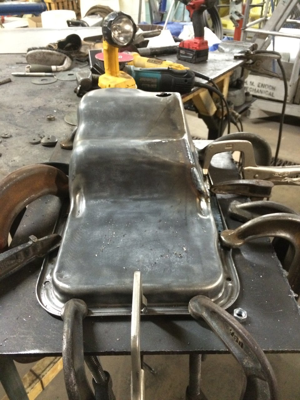

    How much can one notch/dent the oil pan before I hit something? Trying to decide if I can get a little more up travel by notching the pan.
    Pictures from bayareataco build and concerned about the long notch across the front. Mines probably about the same from self clearancing lol.

    A decent amount, the limiting factor is the oil pickup tube. Checkout my build and buried in there you can see what I did.

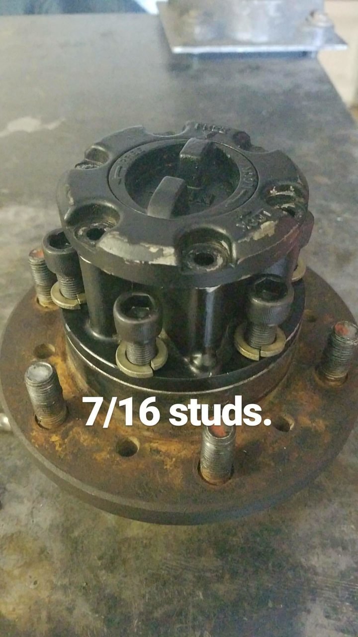

    Got one hub done and bent the drill bit on the 3rd hole of the 2nd hub so called it a day. Got both knuckles on and should have it done next week when Im off again

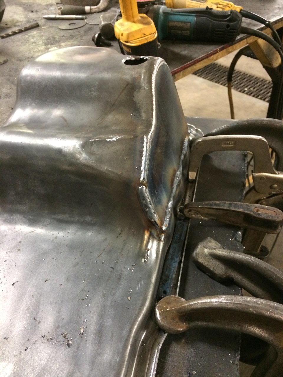

    @malburg114 if you notch your oil pan, you will want to put studs in the block instead of using the oil pan bolts. Those bolts are super weak and will break right off, and you will probably warp the pan welding it, the studs will let you torque that pan down tight. I got my studs from Ace hardware, but if you have any halfway decent hardware stores near you should be able to find metric studs that work.

    I decided not to notch the oil pan and am just going to lower the bump stops. The amount I would notch would let the steering get into the frame and would only be for maybe 1/4".

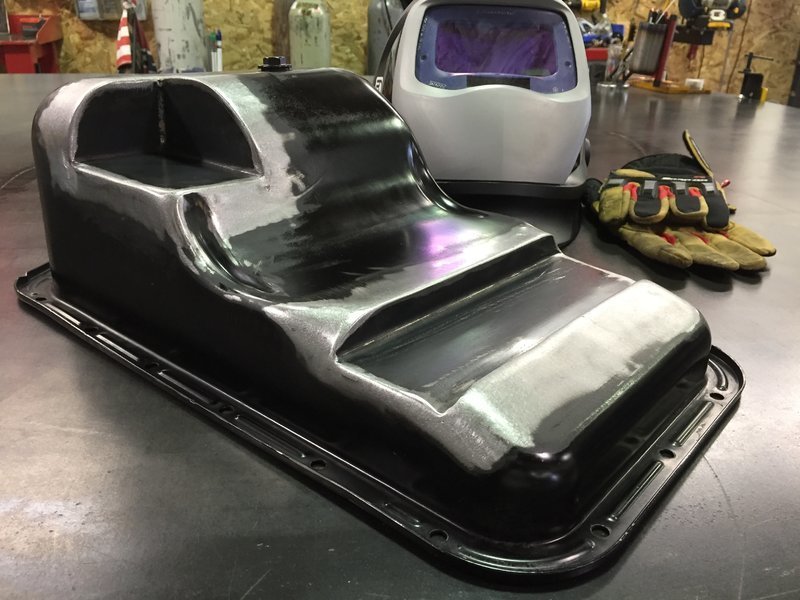

    The only thing to worry about is the oil pickup tube which can be cut and modified as well. I used a modified 3.0 oil pan with a modified 3.0 oil pickup and the stock 3.4 baffle. It was worth it for me. Let me try and find some pics.
