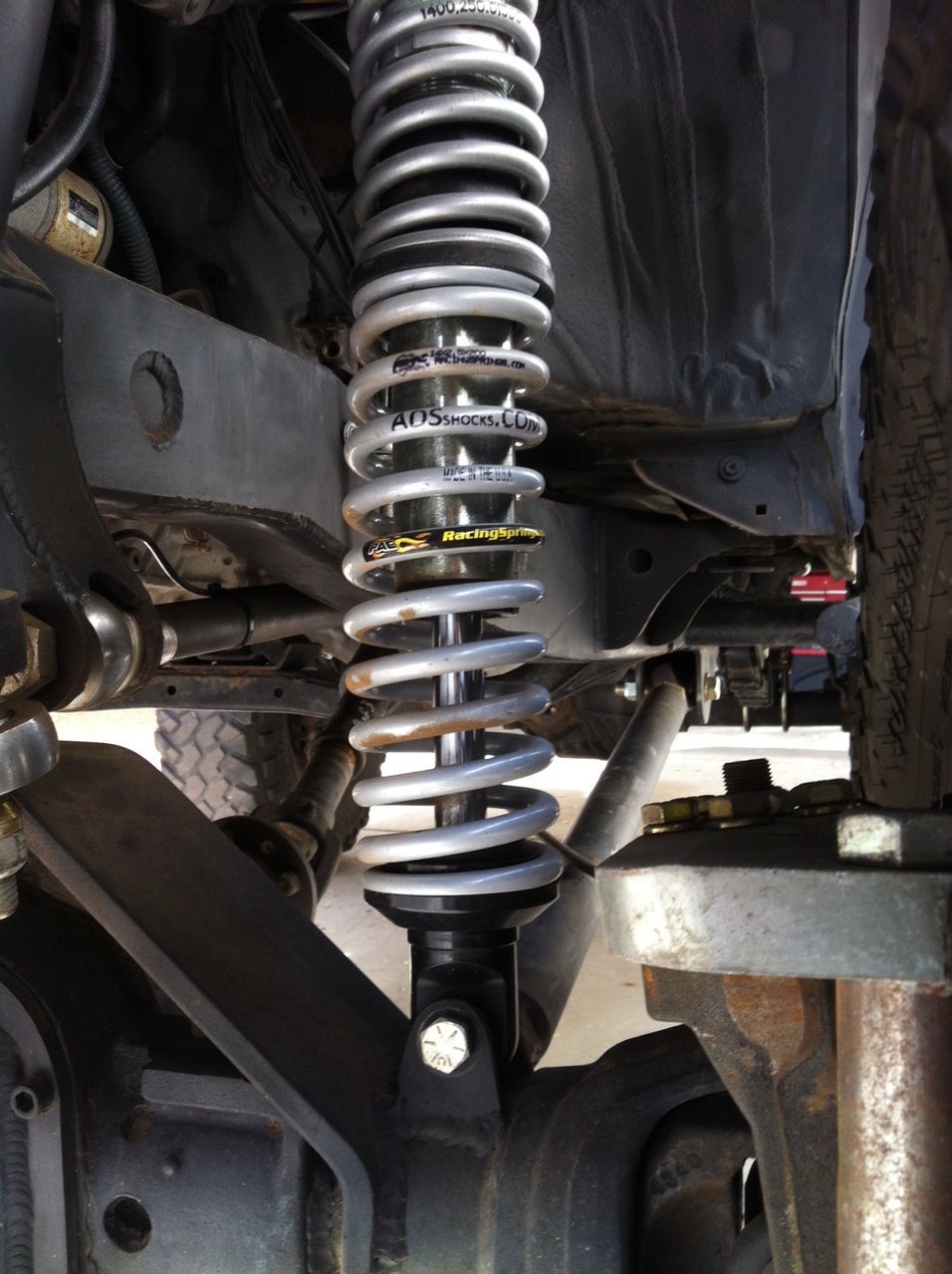

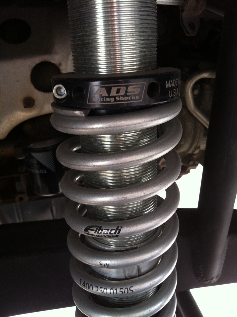

    Couple of pics of my ADS coilovers. These are the regular "plain" coilovers, no fancy bypass, reservoirs, etc. They work just fine, don't see the need for bypass....at least not yet. Well under a grand for the pair brand new with springs. Can't beat that. Really good product. ADS1.jpg ADS 2.jpg
    As mentioned before, they have built in bumps at the bottom of the shaft sitting inside the coil bucket. I think many other brands - if not all - do this as well. The built in bump is enough, I think, for the average person to go wheeling and be ok. I might get air bumps down the road, but for now I'm ok with the cushion the built in bumps provide.

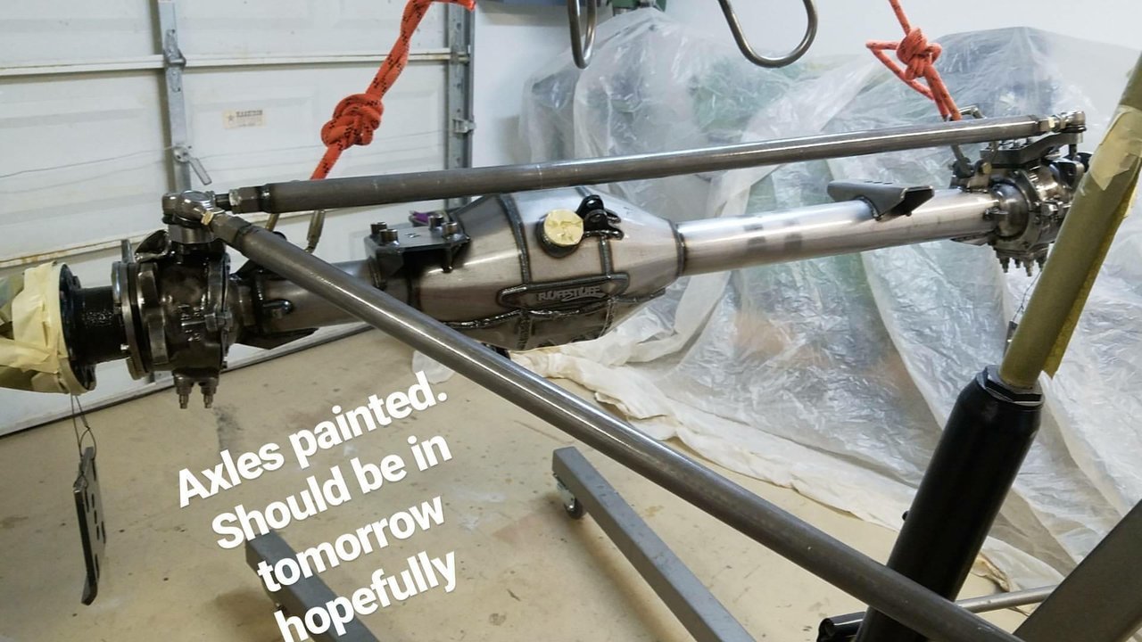

  18. Dec 21, 2017 at 7:21 PM
    #9838
    Timbo's Customs
    Timbo's Customs Well-Known Member
    Aug 8, 2013
    #110078
    7,266
    Timothy
    Lakeland FL
    2019 f250 6”lift 37s deleted 1997 T4r, tons and 4ds
    1997 t4r has super duty axles, 5.13s locked front and rear. 3 link front with 14" kings. Rear 63s.
    Clear coat to keep it looking awesome?
    Acerwin and malburg114[QUOTED] like this.

  20. Dec 21, 2017 at 7:23 PM
    #9840
    malburg114
    malburg114 Well-Known Member
    Dec 26, 2012
    #93766
    3,818
    Las Vegas, NV
    2001 Toyota Tacoma TRD
    Yeah was going to paint it black. Thought this would look better and always liked the baremetal look.
