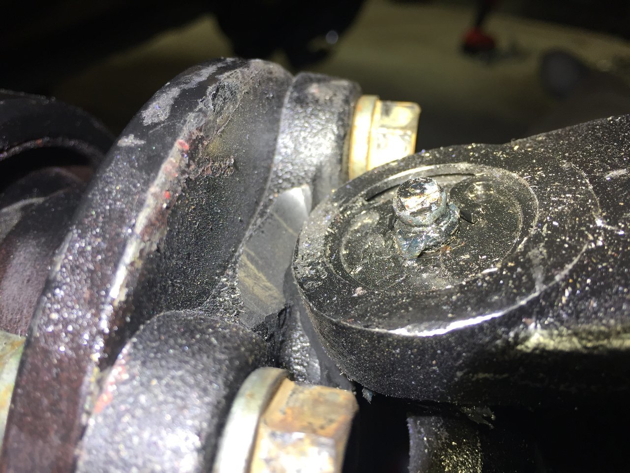

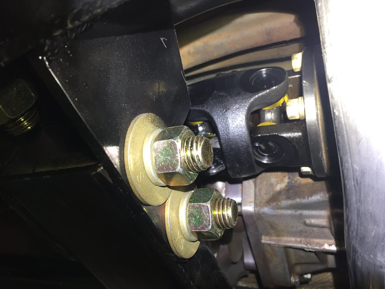

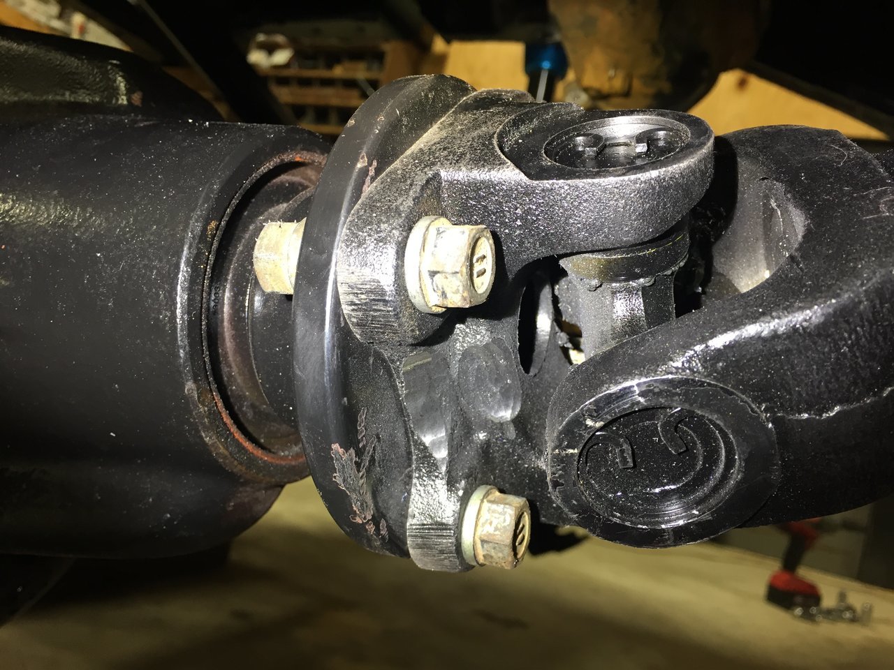

    I don't have any pictures of my cardain joint, but it is clearanced. My front ujoint ended up binding at full droop so I clearanced that one myself. I didn't have to grind out much to make it clear though.
    Droop everything out and see where it hits, then decide if it's worth tearing it apart to grind on it.
    This is the only pic I have of the double cardan. It's hard to see, but the ear on the outer joint has been shaved down.
