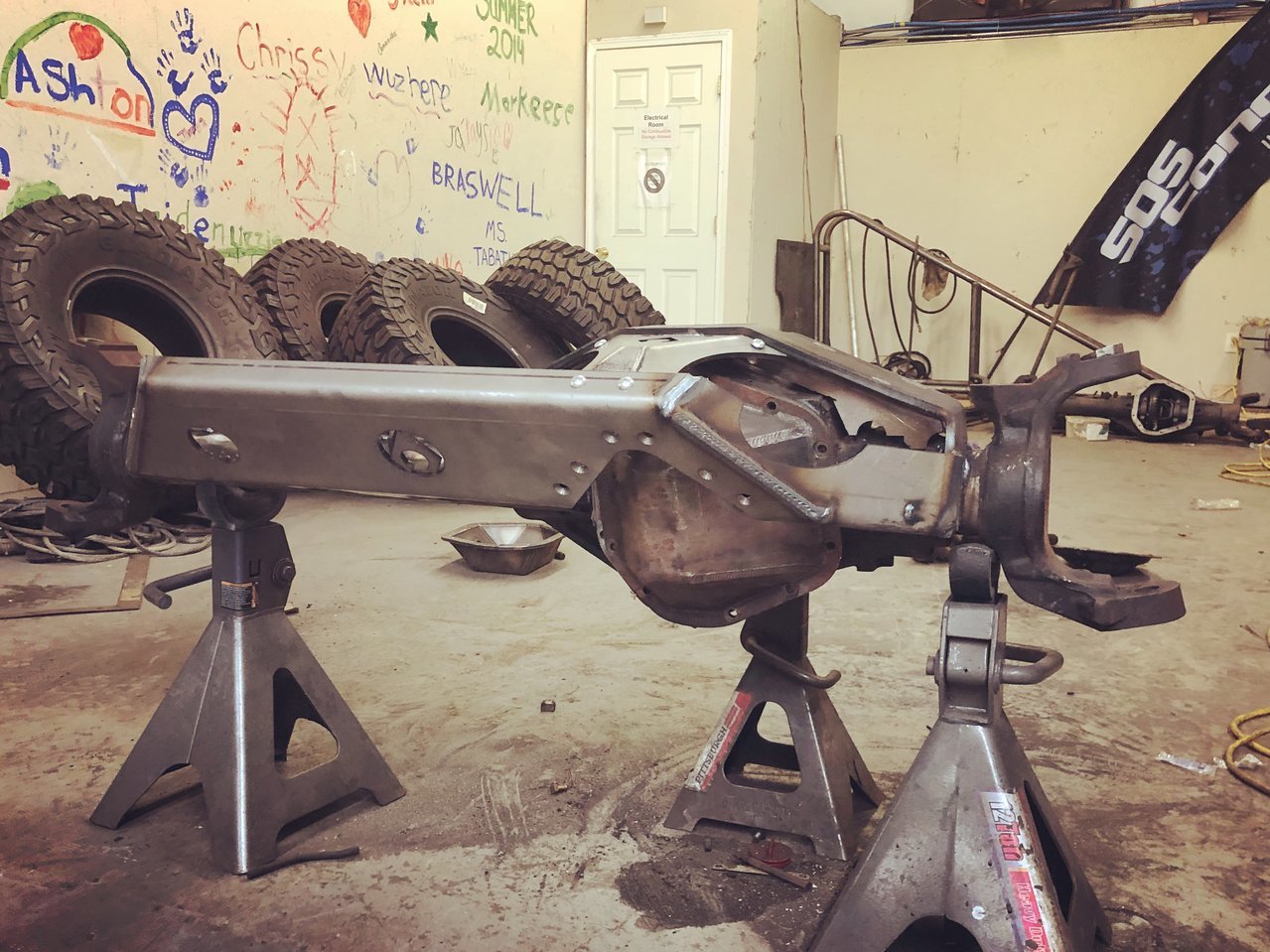

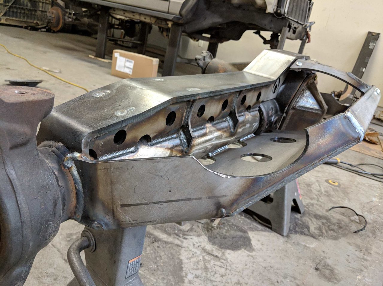

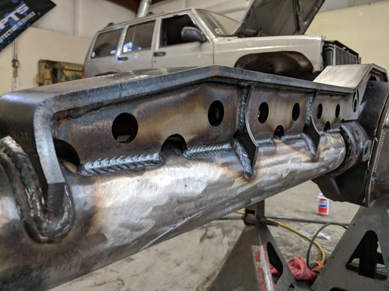

    Straight beef 0F45946A-E070-484A-8F6D-F265DAA9E62B.jpg A657BD46-81BC-49C6-B833-D785D0CB5C3C.jpg

    Love the way this is turning out. Beefy af. FD2534CF-A5AA-477B-8A01-6A8FC6CBF340.jpg

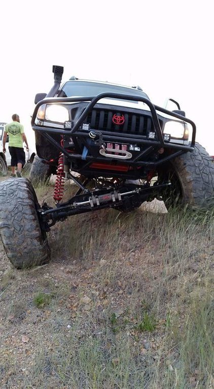

    why are all of you afraid of being tall? my frame height is like 31" or some shit truck does fine everywhere i go even with the 18" coil overs that are soft and let the truck lean entirely to damn much
    I think this qualifies as high steer have yet to hit it on anything.

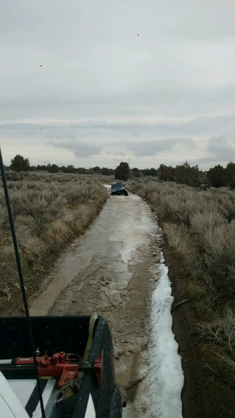

    TTC all tall AF. Why? Deep ass water crossing also when my friends get stuck in the snow they dig out the entire truck where as i just have to dig out two axles
    i went first through this shit and had to back up to pull the danger ranger through this shit.
