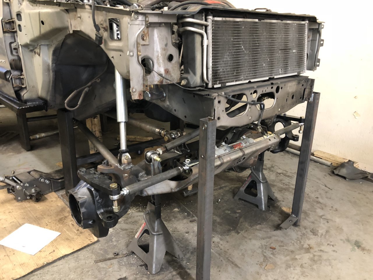

    Got the ram installed today. Just got to finish welding up a few things.8227AE83-1B95-4EEB-968E-F8A79773A7BA.jpg

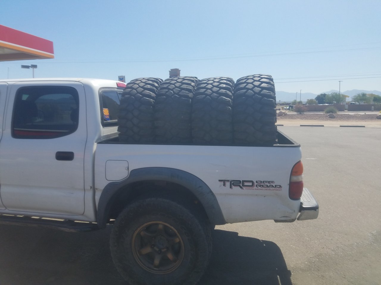

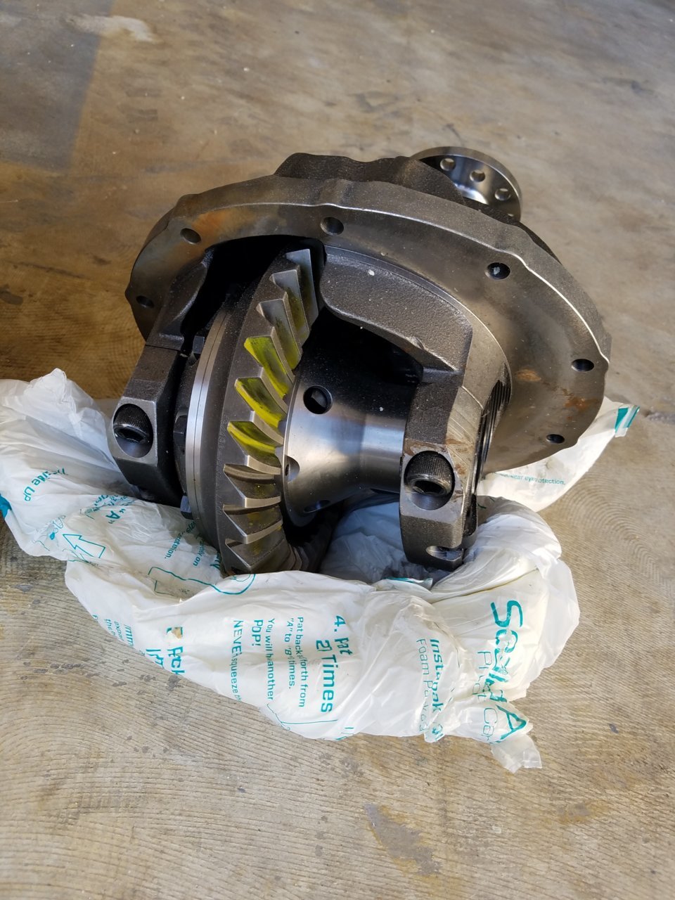

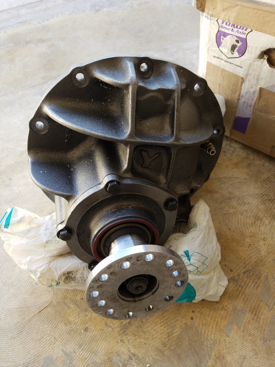

    stumbles
    stumbles 1 eye
    Aug 18, 2014
    #136442
    4,388
    bryan
    mesa
    2002 White Double Cab
    Ok, so far I have axles and wheels. This morning I went and picked up some Maxxis 40s for a good deal. There is another one on the other side if those. Next will be gears/lockers and then a daily driver. Still hoping to start this fall.
