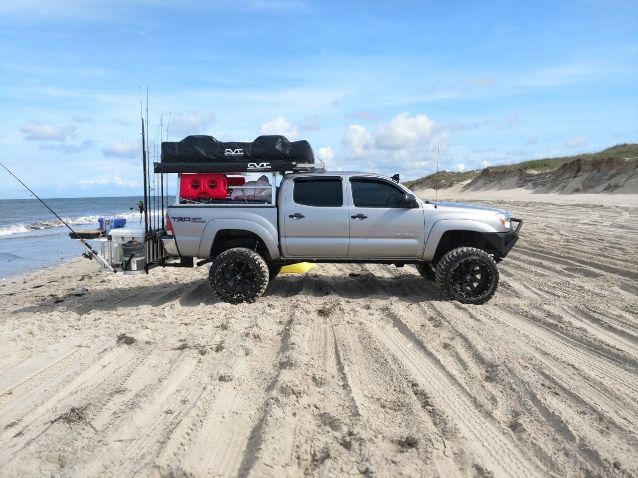

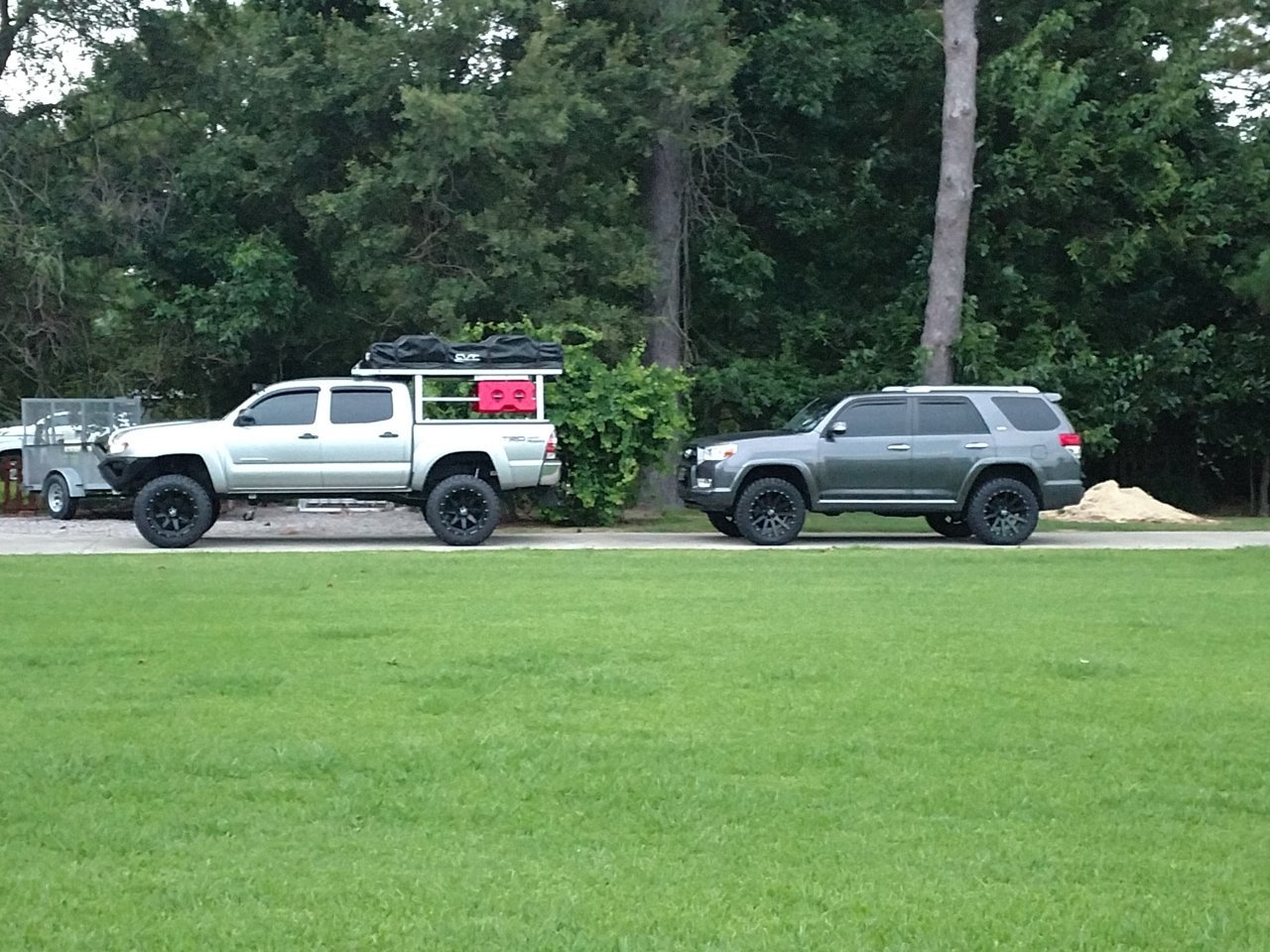

    How do you clear a 33 inch tire with 3 inches? I have the 3inch icon on my 4runner and 285/55r20 Nitto Trail MT's and they rub slightly in the bumper. Can't imagine a 33 on 3 inches. Plus I hate tire rubbed and like clearance. That's why I went with the drop bracket set up.IMG_20180717_201738524_LL.jpg IMG_20180609_162654047.jpg

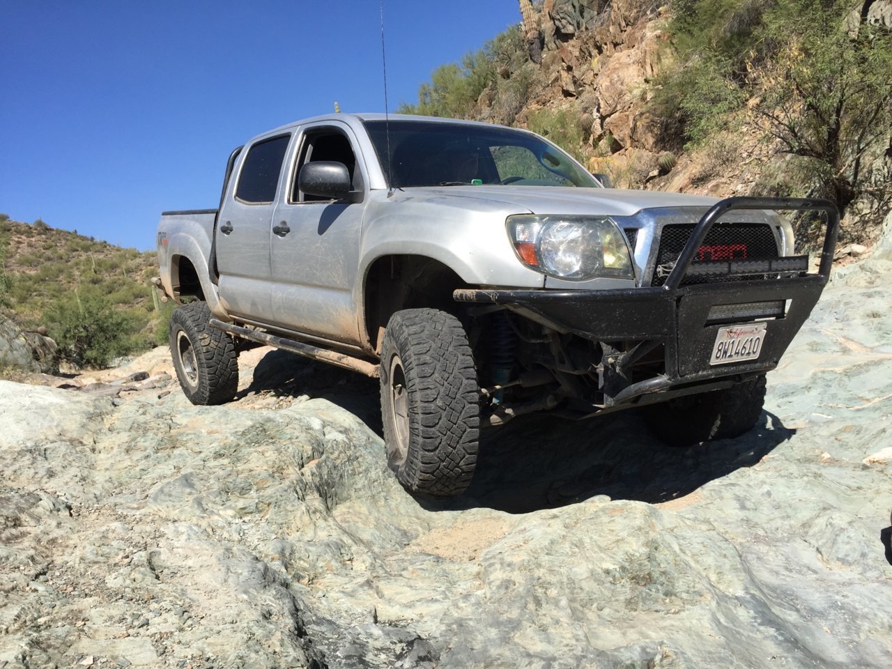

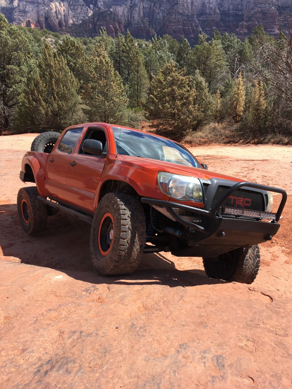

    Cab mount chop, beat the pinch weld back, and good alignment specs.
    33's and 3" lift
    35's and 3"
